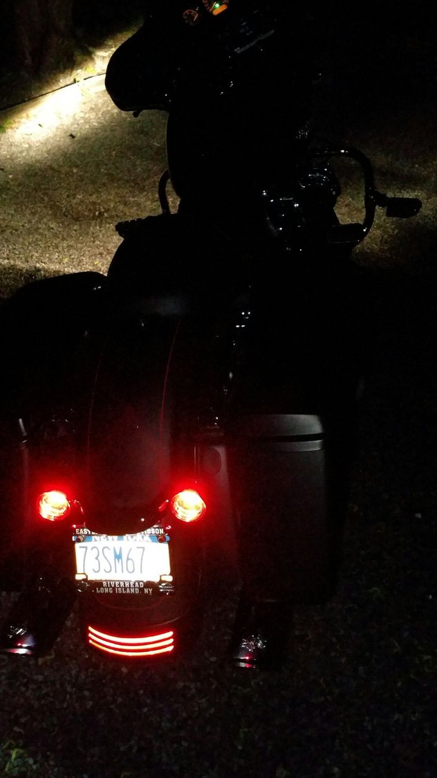

Old Sep 17, 2015 | 03:28 AM
chrisg81983's Avatar
chrisg81983
Joined: May 2015
Posts: 607
Likes: 41
From: long island
If they are the same 1157 I used in front and back the base flanges were bigger than light bezel opening. I used my lathe and turned down the excess circuitry board and aluminum leaving just enough material to keep it together. They work awesome after that.
