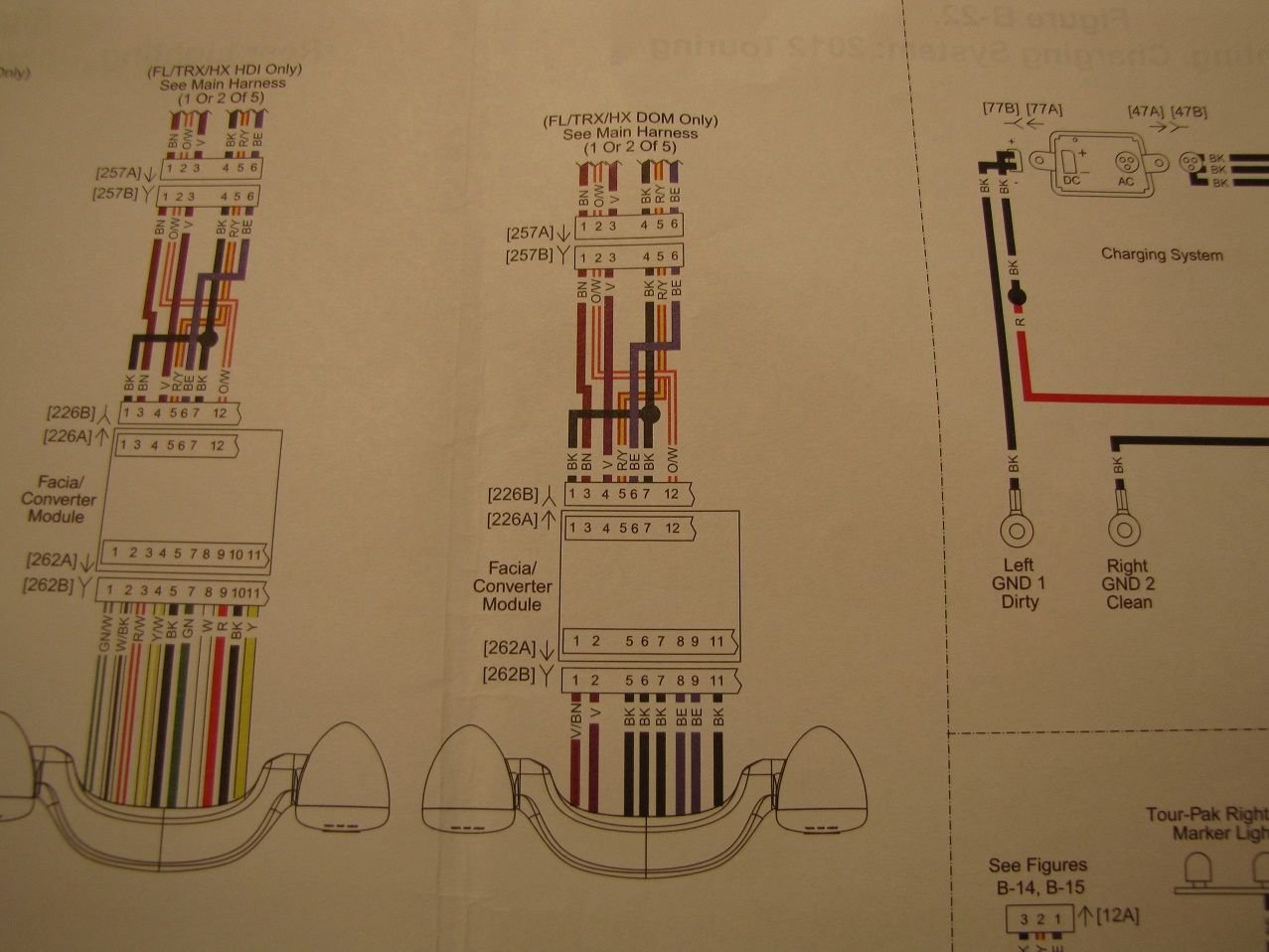

Old Mar 24, 2016 | 08:16 PM
Vernal's Avatar
Vernal
Joined: Apr 2013
Posts: 7,675
Likes: 8,401
From: Utah
Let me know if you need any other drawings.
