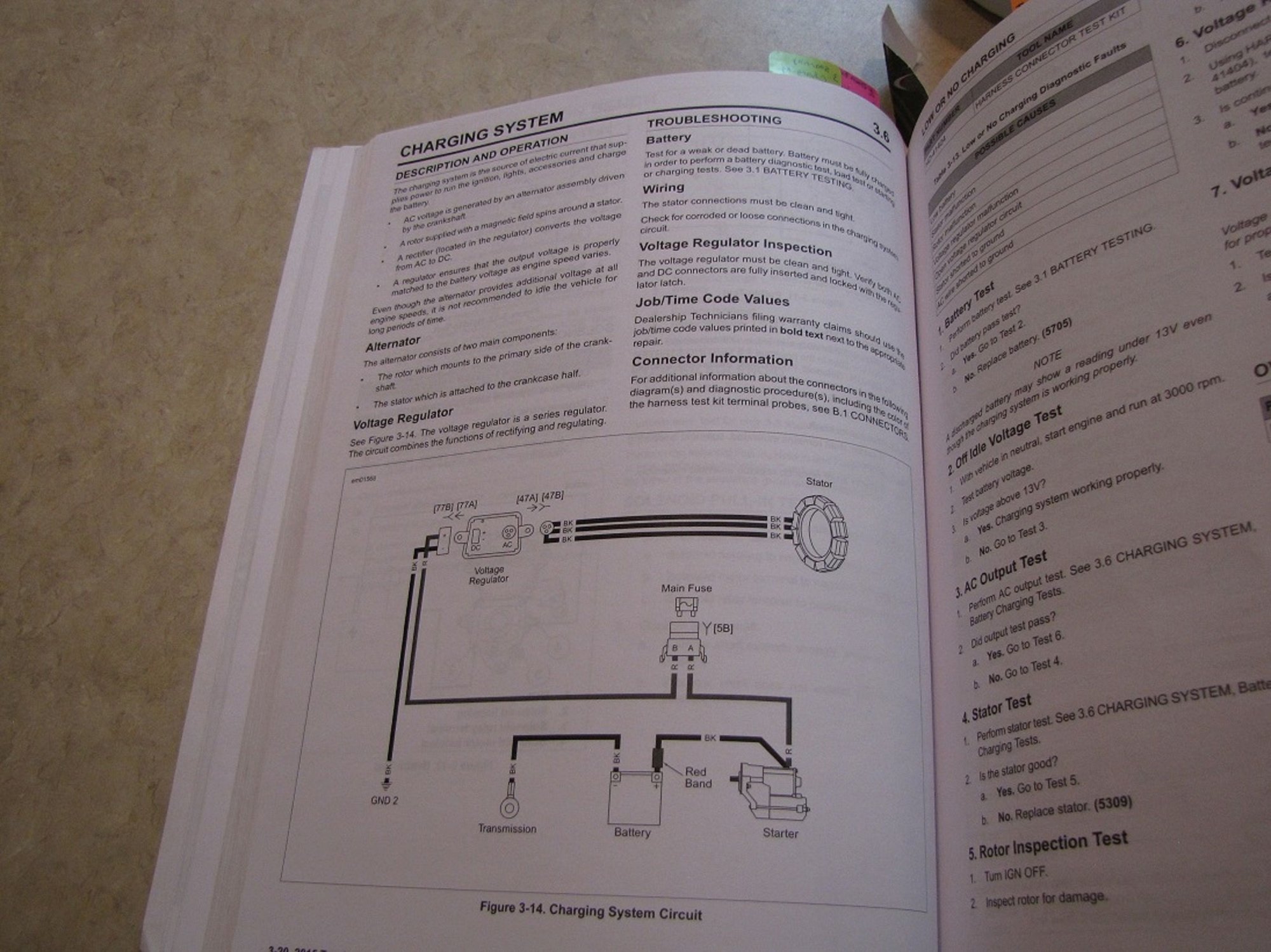

Here are some tests you can do to check the system.
Old Jul 23, 2016 | 08:37 AM
Esiegel91's Avatar
Esiegel91
Joined: Nov 2012
Posts: 19
From: Phoenix AZ
Thanks man I appriciate it! I'll test it tonight

Alright guys so after running the charging system tests. The voltage regulator was pulling a lot of current (.7 ohms) so I replaced it today and the bike is good! Thanks for all the help!
