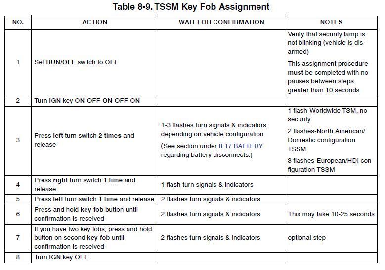

You can get a new TSSM and install it in the bike, there is a sharing of the passwords that takes about 2 hours to complete that will be bike on for 30 mins, off then on for another 30 mins and so on. That will marry the ECU to the TSSM, the new TSSM should come with FOBs. You can download the owners manual from the Harley website in the Owners section. They will be a series of PDF files. The service manual will give you the step by step as seen in the example from the attached page from 2005 Softail service manual.

Additionally if the security system is already disarmed you may be able to purchase just the FOBs if this is the push button FOB and follow the example in the attached file to pair the FOBs with the TSSM.
