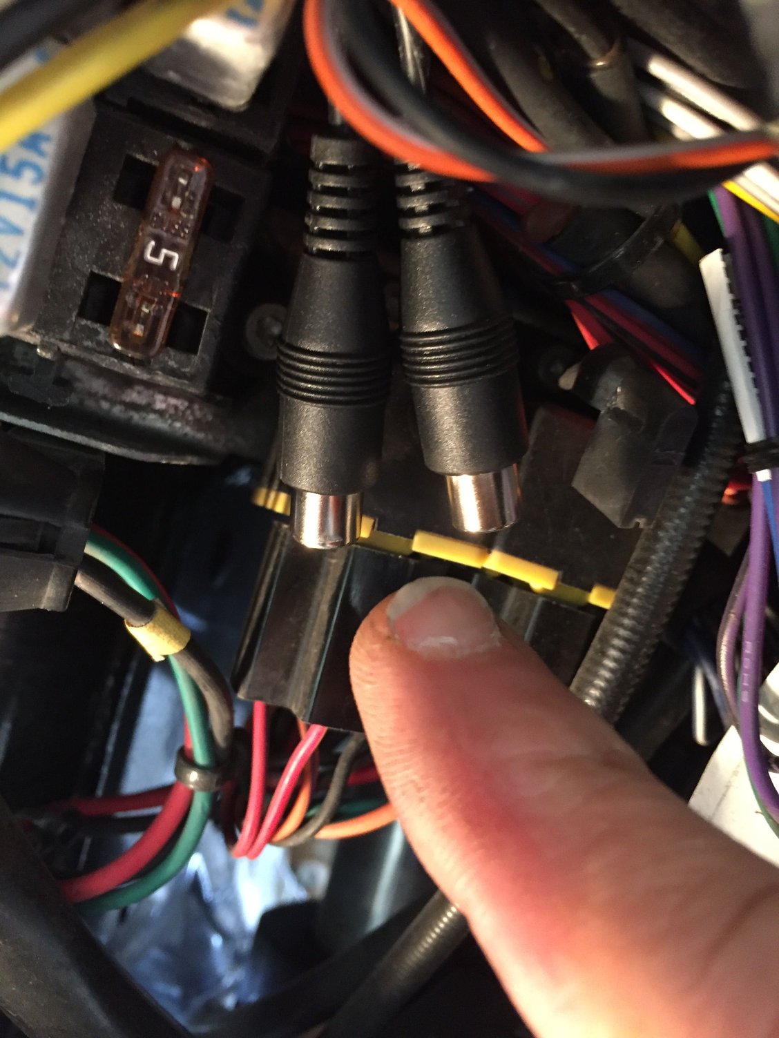

Are these fuses, and if so, how are they removed from the rubber holders? Trying to check radio fuse on a 1995 FLHT.

Those look like RCA jacks to me.
yea, I didn't mean "inline", but wasn't sure what those were. Someone mentioned "relays"?

That square thing you have your finger on is a relay....the two cylindrical things above your finger......yes.....look like RCA jacks.....on the tips will be color coded.....

Definitely RCA jacks. Probably some type of splitter. If you are having problems with the radio you need to find out where those went, or what was connected to them.
