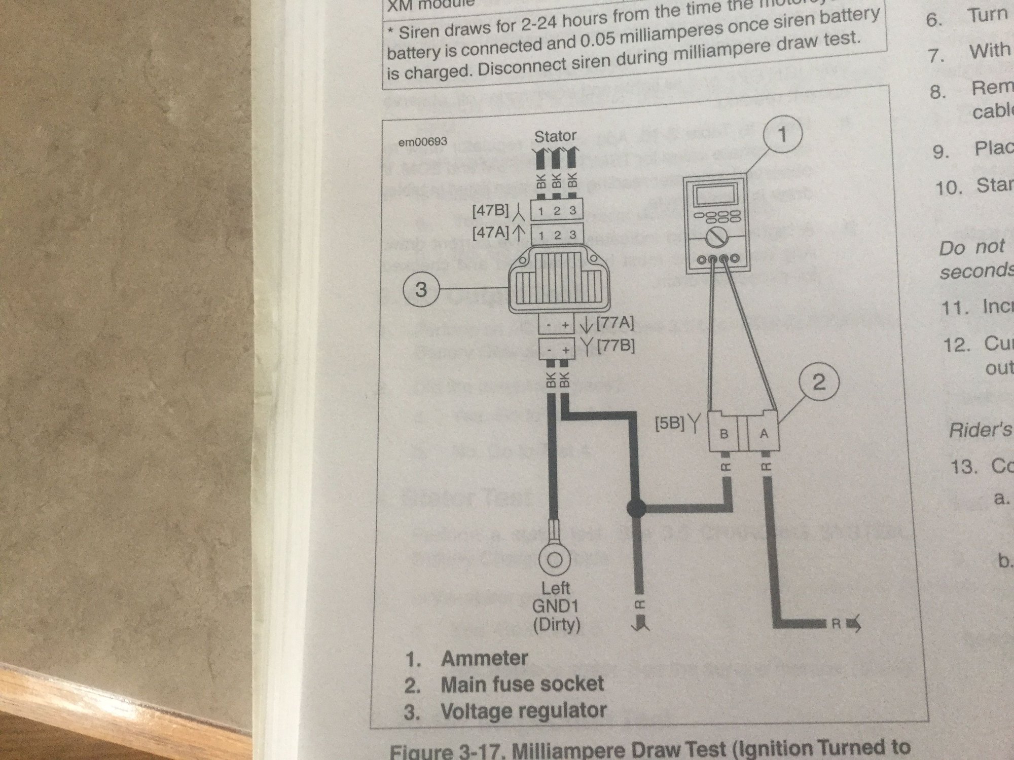

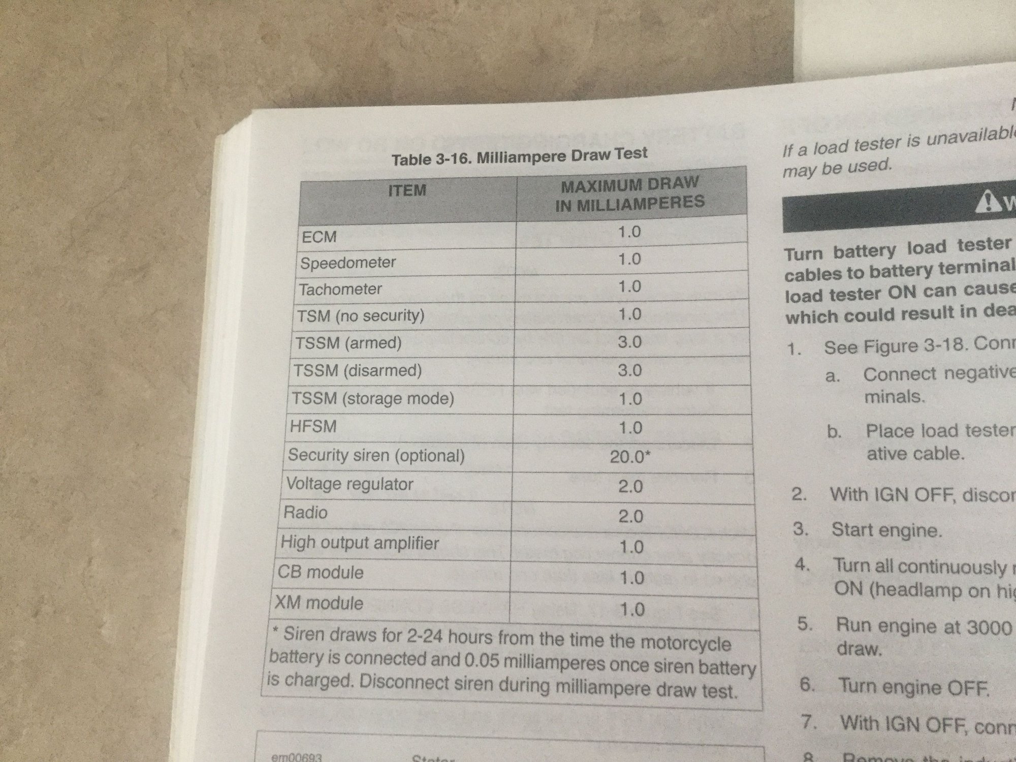

Soft2012 welcome to the Forum.
Im posted a good video, Eric the car guy explains how to find a draw if there is one. Here are a few pages from a 2010 Manual .
Good luck
