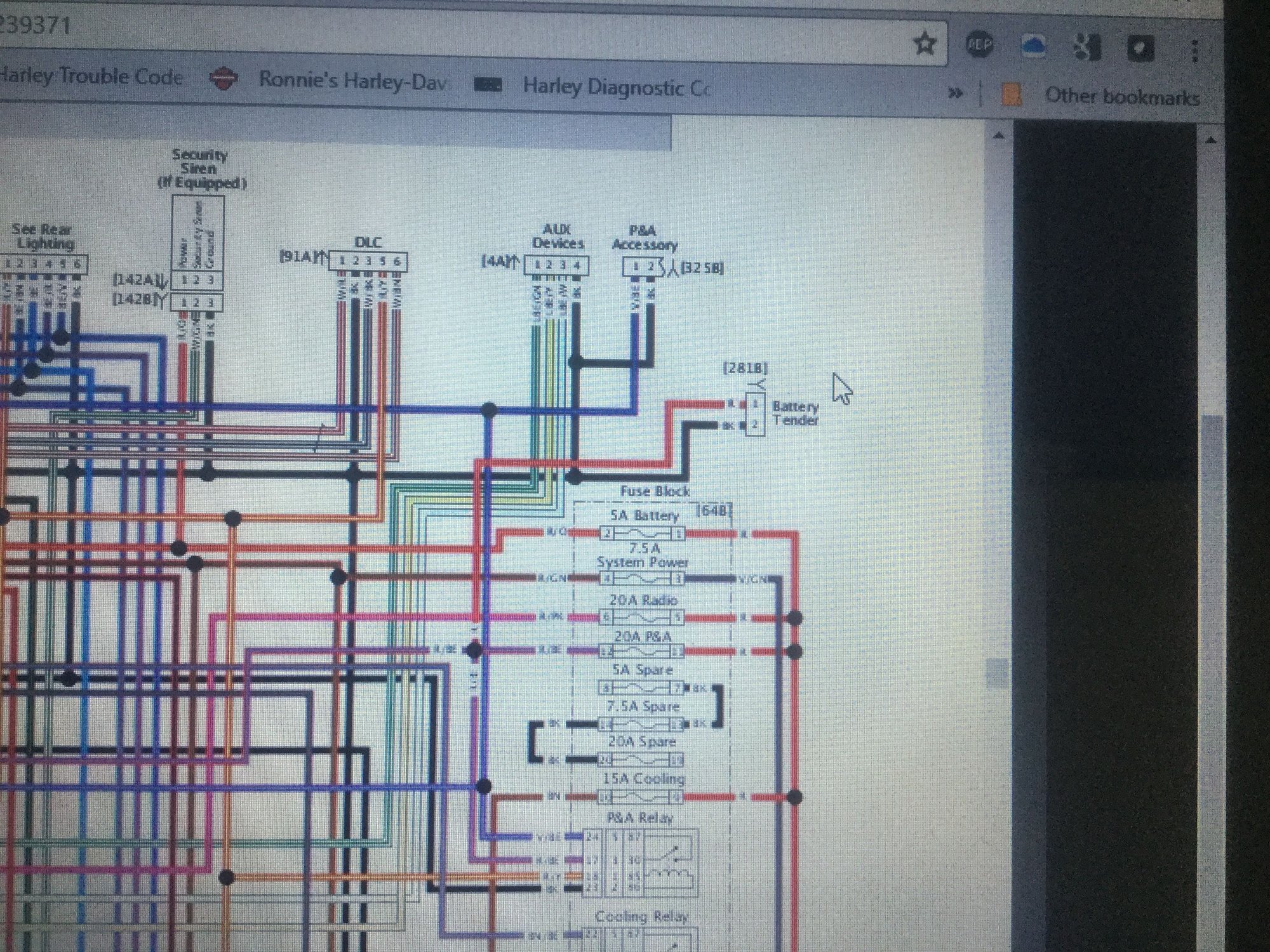

here I go again, thought it would be an ez install but as usual it’s biting me in the ***! I have a new 2018 triglide that I am attempting to add driving lamps on the crash bar, the problem is that it have the correct wiring harness #71400129 and that’s all good except for trying to figure out step2 and 3.....I’m confused to say the least, I can’t find accessory connector 325B to save my life. It’s supposed to have a secondary lock so you can insert the terminal end into a cavity.....I’m not the smartest guy in the world but believe it or not, I’m not the dumbest. The instructions with the harness are not the best and they tell you to see the service manual, which I do, but no mention on 325B and the procedure to install the fused harness.....this is driving me nuts......help.....and remember that it’s a 2018, that may make a difference....

I would guess it's under the left side cover

My '03 FXD service manual has an appendix in the Wiring Section that describes where to find the connectors on your bike. If you have the Service Manual for your 2018 TriGlide try to find that appendix and go from there I'd suggest....

Accessory connector is under the seat in front of the battery. From factory it has a cover on it.
