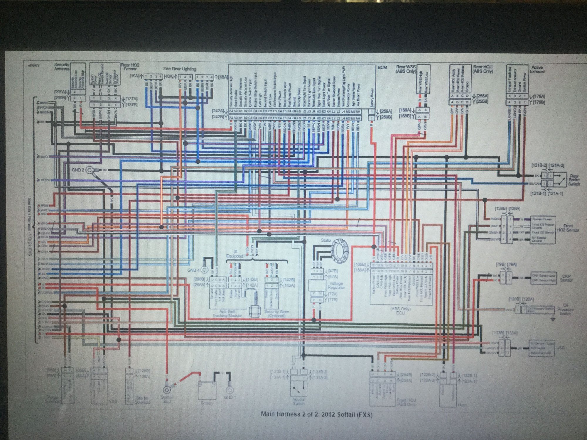

The first error code seems consistent with what I observed when I still had power, my starter was audibly trying to start the engine, but I couldn't hear the pump prime. Do I need to run a new wire to my fuel pump? How do I figure out which wire? Where do I splice it in?
Or if I go to the dealership, what should I make sure they do?
By the way, I think that when I bought the bike (new), a few wires were not routed where they were supposed to go, and there has been unnecessary wear on them as a result. I'm guessing that bundle will have the culprit in it.

If you have an idea as to where wires may be compromised in some way go ahead and take a look. It may be as simple as reseating a connection or patching a bare wire. If not I don't see why the dealer won't find and fix the problem? Of course that may be expensive but it will get fixed.

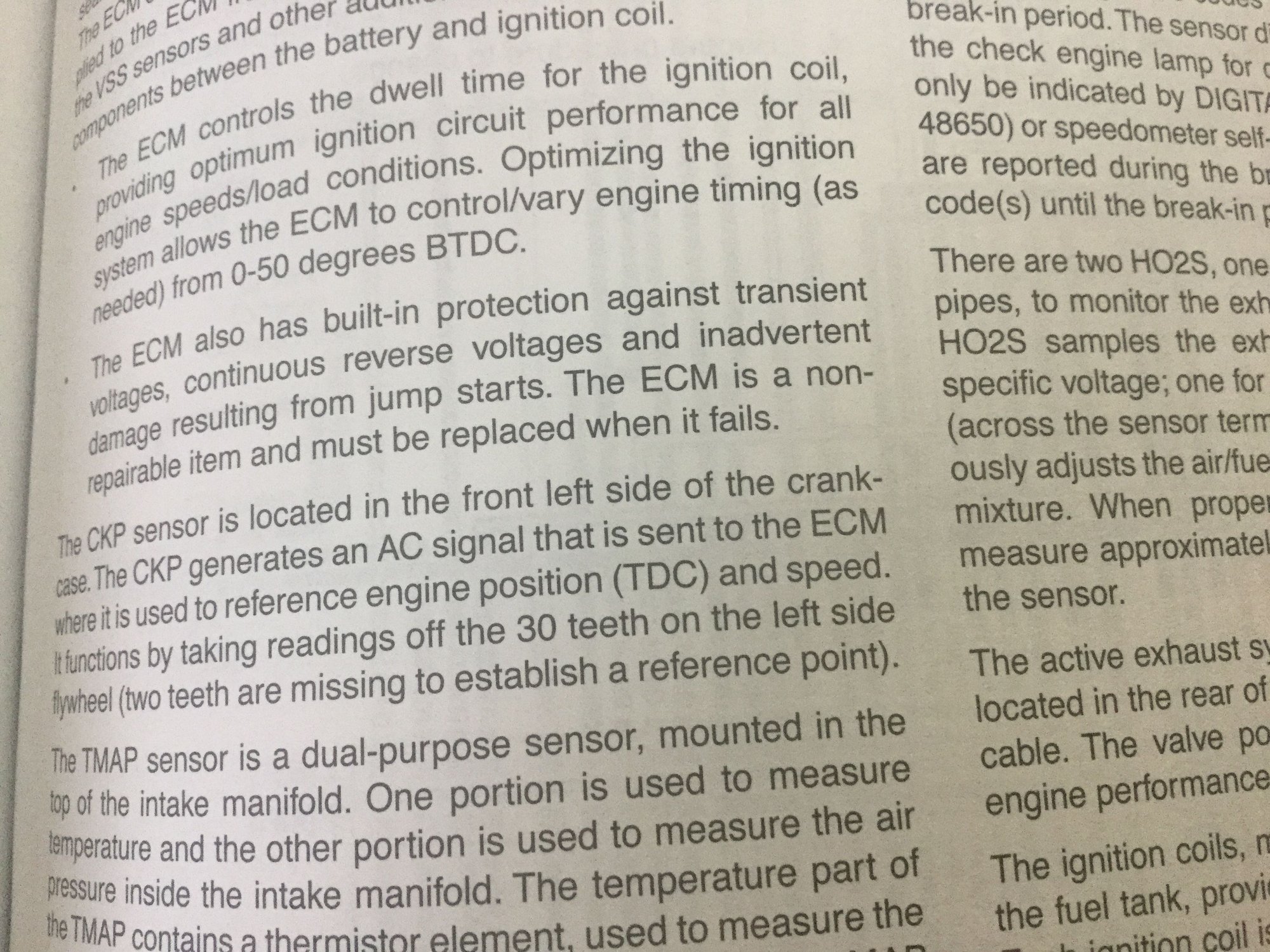

The Fuel pump comes on and primes for 2 seconds then turns of if the CKP doesn't give the ECM a signal the the engine is rotating. If you turn the ignition off you have to give it 10 seconds before you can turn it on and listen for the pump again.
Does the pump come on when you turn the ignition on after it's been off for 15 seconds?
If it's the original fuel filter I'd say pull the pump and look at filter and hoses. Check all connectors. Pull CKP and take a look at it. Check where the pump grounds for a loose connection.
