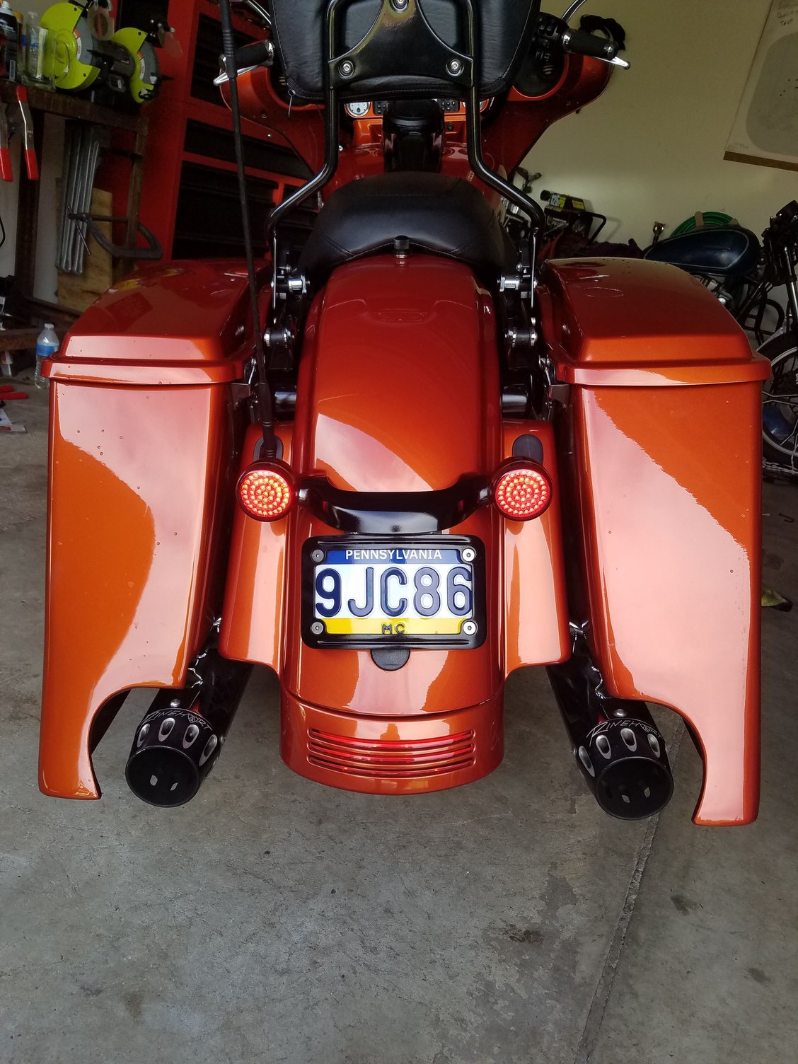

Hello all, over the last couple days I've torn my bike apart and put it back together more times than I can count, I have an 11 Street Glide 103, I had issues at first with no turn signals all the way around, (all lights on the bike are LED) when this happened it through codes P0572, B1123, B1124, B1006, U1016 , and U1040. I looked all over the bike for an short and didnt find anything, I replaced the accessory fuse and lighting fuse as they were both blown, I removed the Badlands ILL-01-SR and tested it with a test light, I wasnt getting any power through it with the test light so I replaced it with a custom dynamics GEN2-SSR, now I have a brake light on the fender tip but still no turn signals. I plugged in my thundermax software and removed all the DTCs. Anybody experience the same issue or have a possible fix?
Thanks in advance
