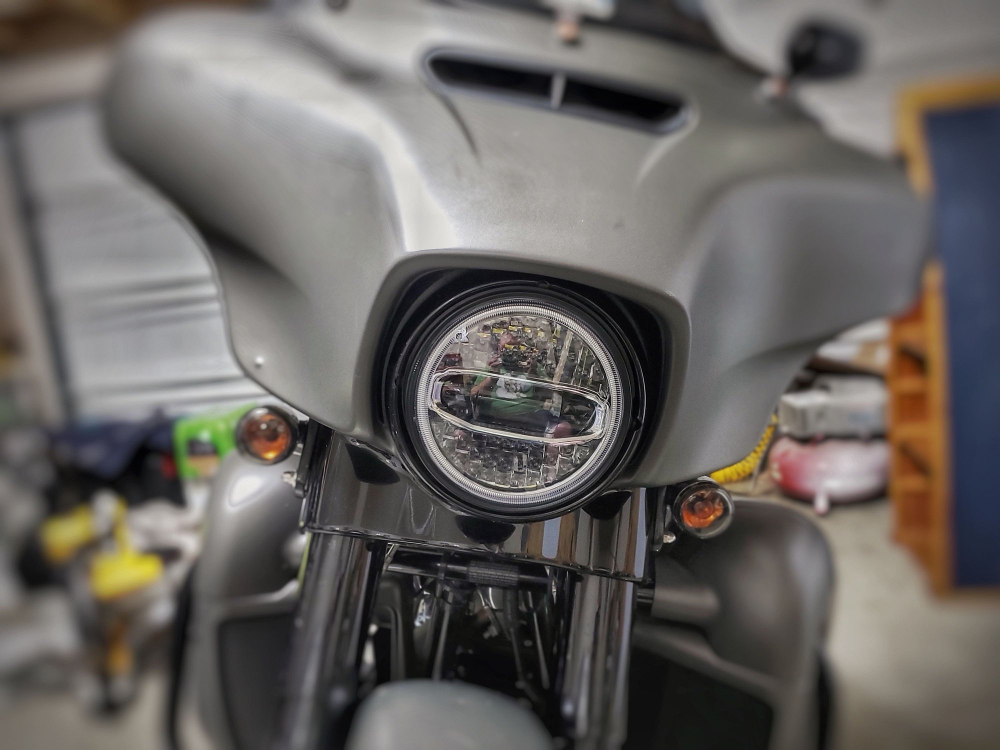

I just got this one from amazon for $89.
