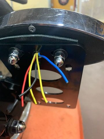

Ok so I am doing a 98 dyna wide glide into a bobber and for a while I been watching this brake light signal combo set up. Used condition. I bought it and it has 5 wires coming out of it. So I want to wire it in to my bike. So any starting points? I can get pics or wire colors if someone can help. thank you.

Start with the picture. But 5 wires sounds like it has built in signals too.

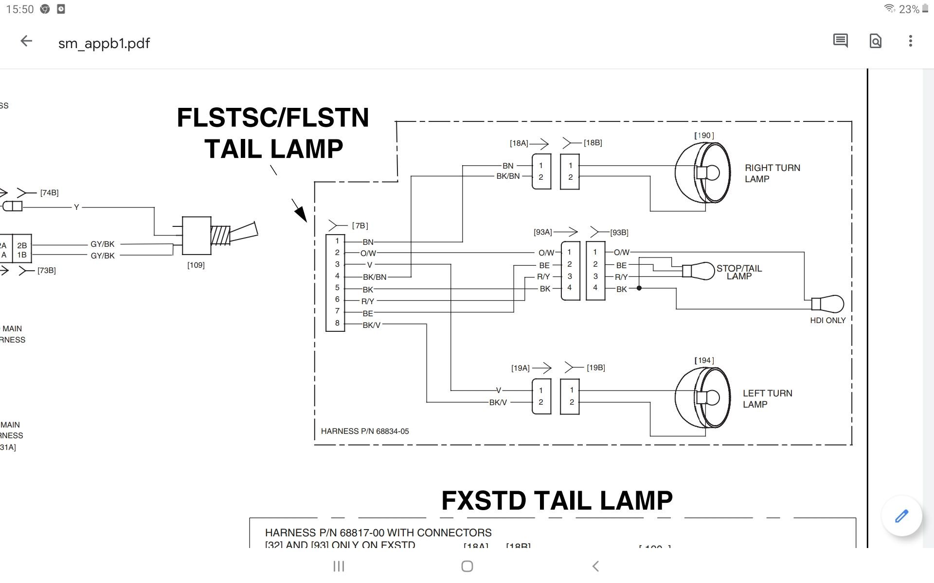

Not sure of wire colors on the device itself but for the main harness it would be:
Y/R = Brake
BE = Running light
O/W = Fender tip light
BK = Ground
BN = Right Turn
V = Left turn

It has signals in it 2 small yellow left and right then red brake in center. Thank you so much for your replies and help. Just dont want to start touching wire to wire without reaching out.

Black is ground touch any of the other 4 to 12 volts and see what wire does what.
