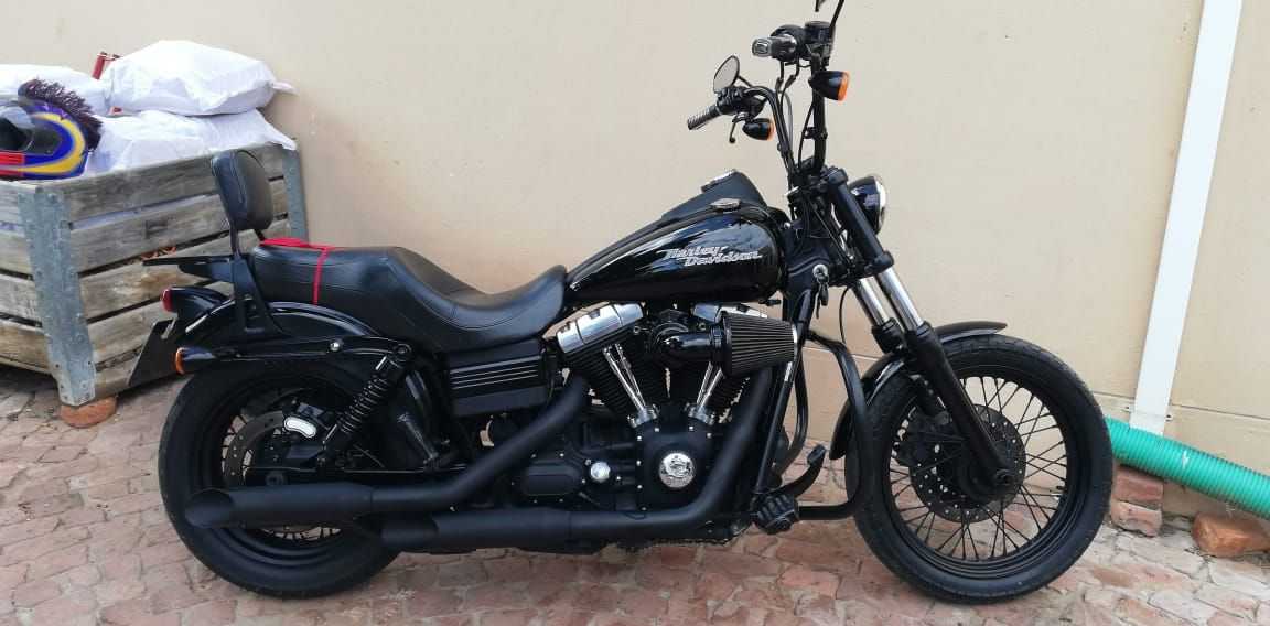

Hi all, seeing as I'm new to the forum, I'm not sure if something similar has been posted before, so here goes:
I am thinking of installing new grips on my '09 Dyna Street Bob (with the wiring running inside the mini ape hangers). So the grips I'd like is ones with indicators at the ends:
Listing: https://www.gumtree.co.za/a-motorcyc...20912518053309
So my question is: Has anyone installed something similar, and how will I go about connecting the wires to the current front indicators (keeping in mind I will remove them and flip my mirrors to below the bars - see image below).
So in a nutshell, I'm just concerned that I order the parts and when it arrives, I won't be able to connect / fit them properly.
Looking forward to your feedback...

So you will not be re using the original signals? Is this an international bike not a domestic one? I saw that the grips have 1156 bulb sockets and only 2 wires so no marker lights, otherwise depin the current wires in the connectors, crimp pins on the wires and install the new wires in where the original wires were, otherwise not much to it.

No, I will not be using the original signals any more - it's a South African bike (I think they import them on UK specs), so my current turn signals is only that, they are off when not in use (if I understand you correctly of course). So the way I see it, I'll only need to hook up the grip indicators to the existing wires, which will be removed from the current ones.
My main concern is still whether I'll need to modify anything to get the wires fitted through the handlebars. The bars are internally wired at the moment...
