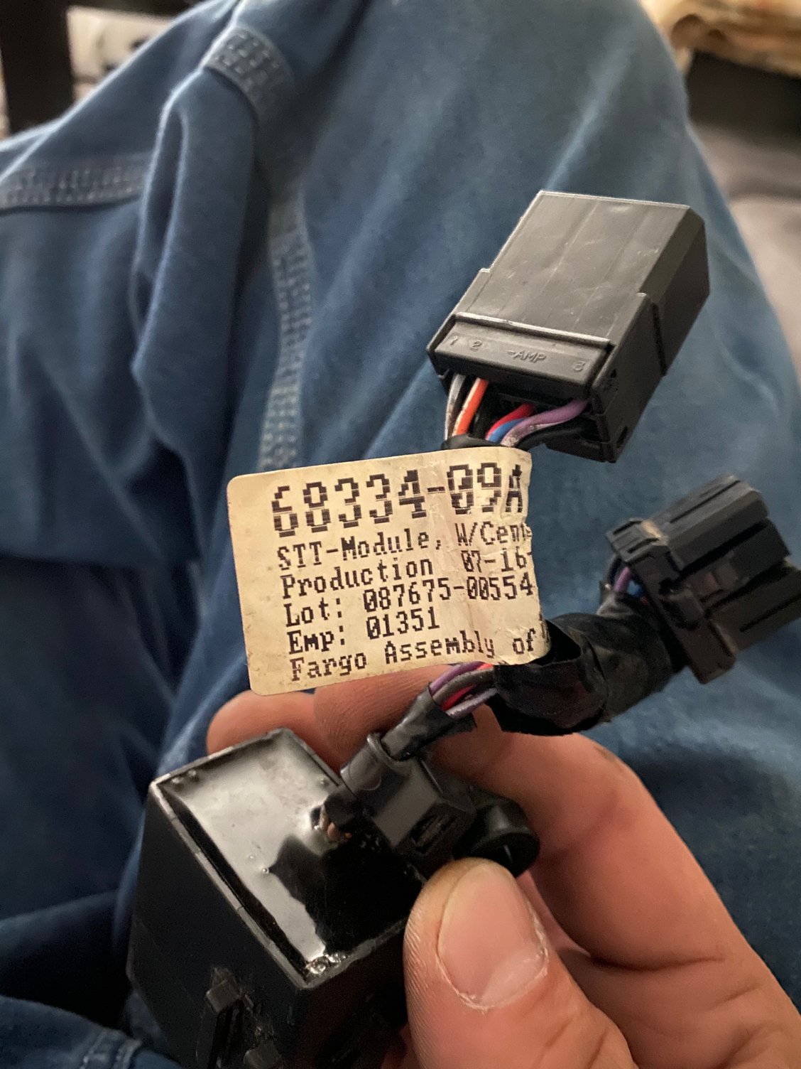

If I still have run and turn signals. But no brake light. Could this be the culprit??
also when I tap on it. the tail lights flicker and one will get really dim, the Not blink at all when blinker is on.
Thanks

Looks like you probably have found the culprit.

Something I probably have to buy from dealership? Can’t really find them anywhere else.

The part is around $120 at the dealership. It is a bit cheaper here https://shop.newcastlehd.com/part/68334-09a but you do pay shipping.
