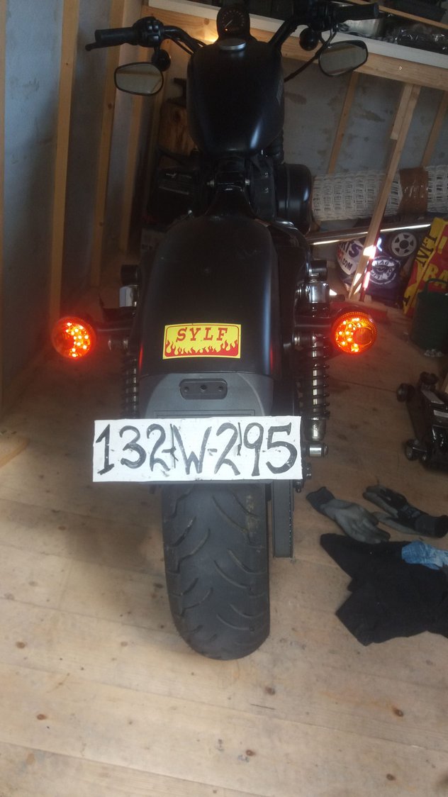

hey to all i knownthis may have probably been answered butbi couldnt quite find the answer i was looking for .
today i fitted the original style license plate .
pain in the hole lol

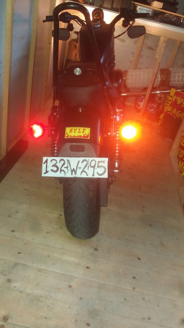

but afterwards i spotted the break lights were stuck on googled it most like a stuck switch on front break lever assembly that was grand fiddled with it seemed fine them went for a spin my missus was behind me in car with kids she said my indicator was on but not flashing only on the right side came home and check diagnostic said same code as before b2262.
it threw that code beforehand also but didnt have the indicator on is this all switch related or do i have another issue any info i only have owners manual waiting on service manual .
total noob to working on harleys always had metrics here in ireland
am hopin by sorting the switch it will be sorted eek
there the break lights are on as per usual but thw right indicator is stuck on too

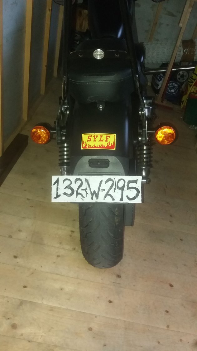

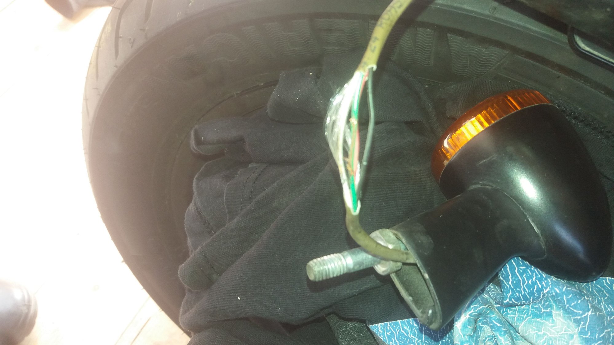

sorted it lads the code it threw was a stuck switch so i investigated that cleaned both pistons inside the lever housing the brake cylinder piston was filthy .
the indicator being on was due to some frayed wires that had not been in the last harness clip inside fender .
i disconnected it pulled the connection as far back as i could get it and took apart sub fram on rear right took apart indicator to get as much wire out as i could cut back the housing a bit re wrapped it taped it up and all sorted beats buying a new indicator thanks for your help lads
after i cut back housing it had rubbed off wheel
sexy license plate hahaha all good now and learned how to maintain the switches too
