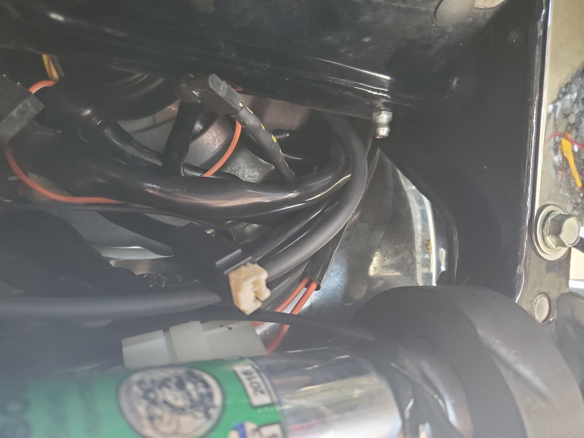

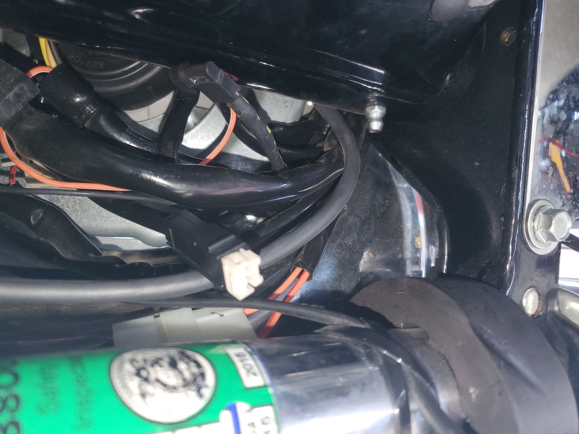

I have a 2007 Road King Custom. I am going to wire up a phone charger/mount to use as GPS. I found a plug behind the headlight. I want to find out what type of plug it is so I can use it without cutting into my wiring.
Thanks!

There is an accessory connector under the seat.
Click on the link:
Link to Wiring Diagram

If that plug was tested and has 12+ voltage when bike is ON then perhaps it is part of the wiring harness for a front fender tip light that goes unused on your model.
While not the mate for that specific connector I find that Posi-Lock connectors make connections and tapping easy and I do not need to search for connectors.
No cutting and it can go back to stock easily.
Here is a link:

What that looks like to me is a multilock connector. It looks like an empty housing has been plugged in to protect it.
Really useful connector part numbers - Harley-Davidson Riders Club Great Britain (hdrcgb.org)
174463-2 | TE Connectivity, MULTILOCK 070 Male Connector Housing, 2 Way, 1 Row | RS Components (rs-online.com)

Thanks Andy!
