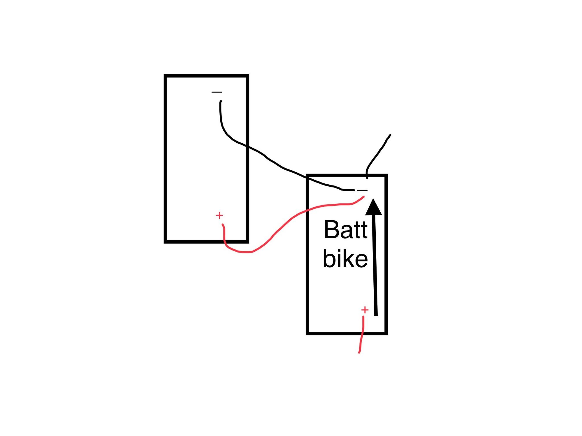

Hi
my brother boosted with another battery to start his fatboy 92 but by removing the cables he touched the + with the -
the bike starts but I fear for the voltage regulator

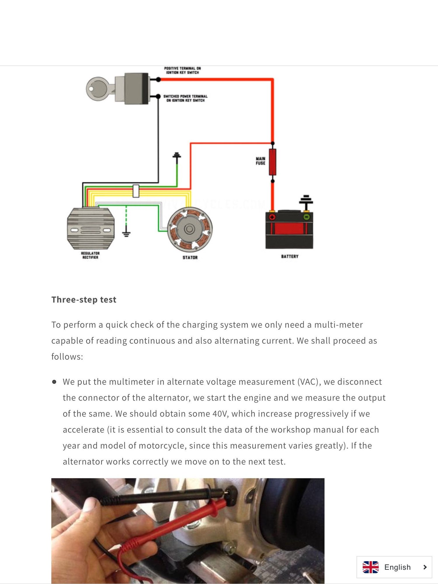

Old Mar 19, 2022 | 04:51 PM
PLANET HARLEY's Avatar
PLANET HARLEY
Joined: Oct 2021
Posts: 96
Likes: 6
From: FRANCE
Old Mar 19, 2022 | 04:54 PM
PLANET HARLEY
Joined: Oct 2021
Posts: 96
Likes: 6
From: FRANCE
they say there is a fuse
