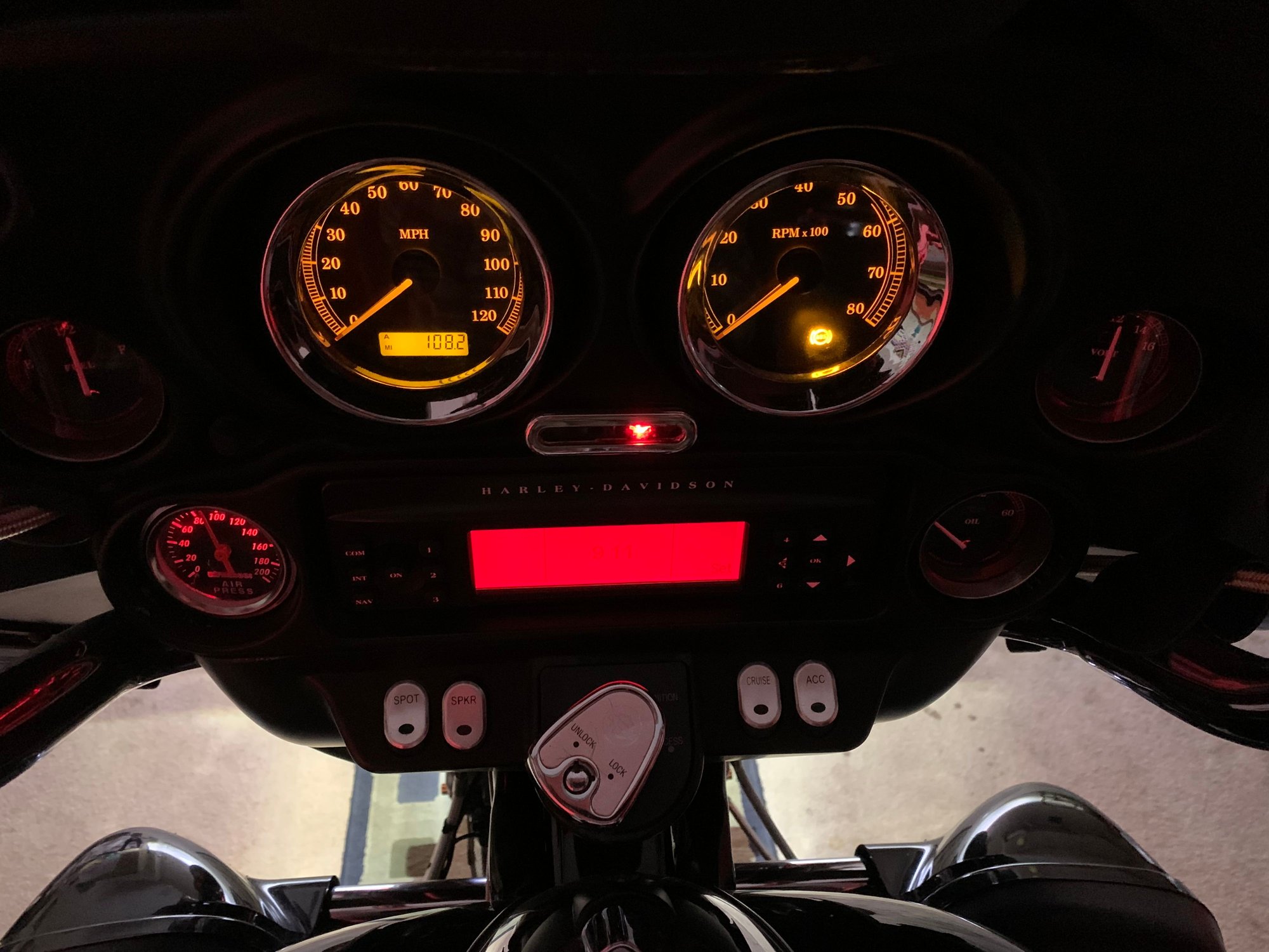

Two of my instrument lights were burned out. I decided to replace them with red LEDs. After about one minute they go dim and after five minutes you can’t even see the instruments in the dark. Please see the attached pictures. They were taken about one minute apart. The tach and speedo light (original bulbs)
The air pressure gauge is brighter because of the different light channel in the non HD gauge
do not seem to be affected. Any ideas? Thank you in advance

Speedo & tach are not 'bulbs', but LED's that are soldered directly tot he circuit boards in each gauge.
I'm wondering if the LEDs that you installed would dim similarly if powered on a bench?
(Trying to separate a potential bike/wiring/installation issue from an actual lamp issue)

Thanks for the reply. I think I got a set of 6 LEDs so I’ll get one out and power it up off of a 12v battery and see what it does. Interesting that the Tach/Speedo are LEDs yet they’ve never dimmed…before or after I swapped the instrument lights.
I’ll post results of my experiment.

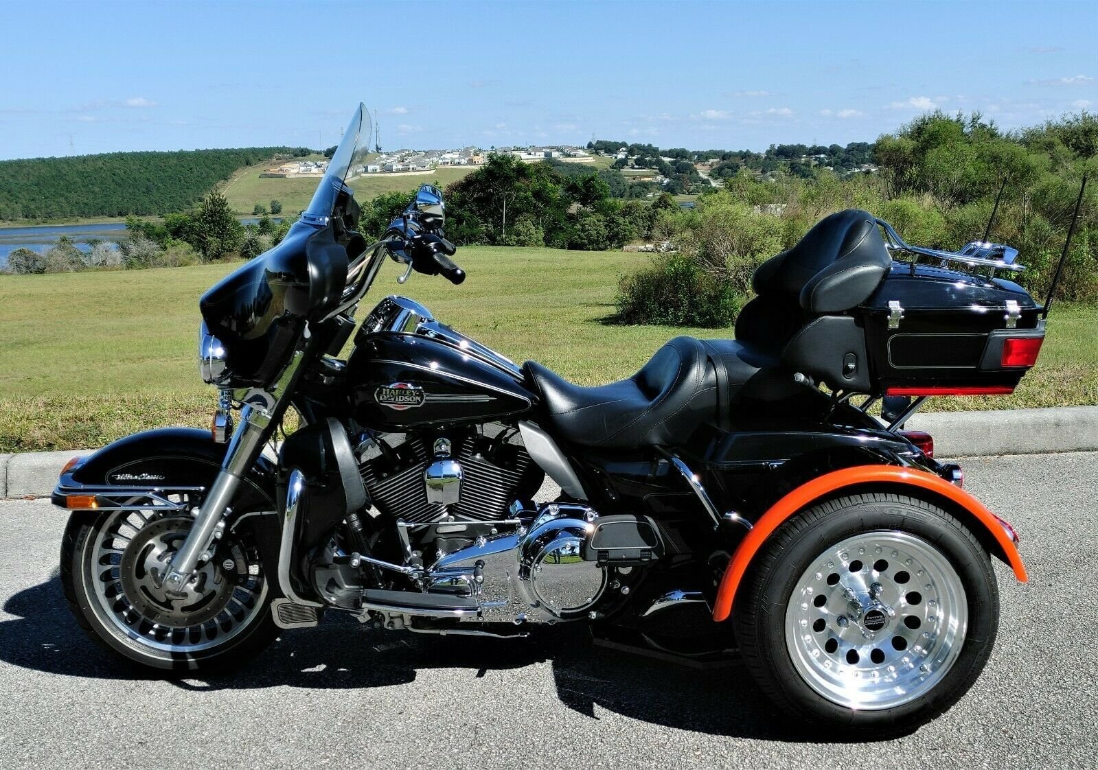

Pic of our bike
