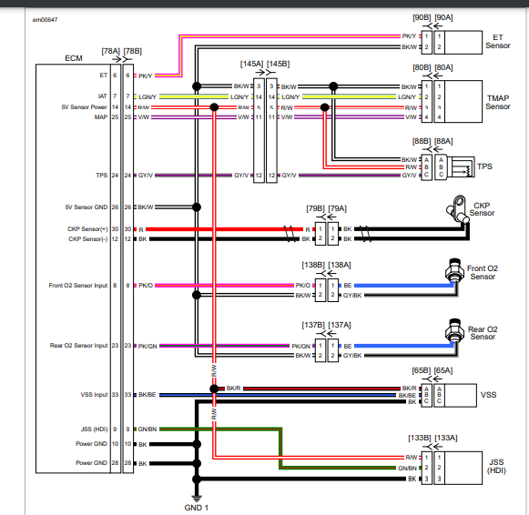

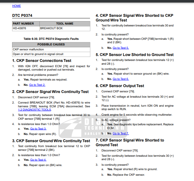

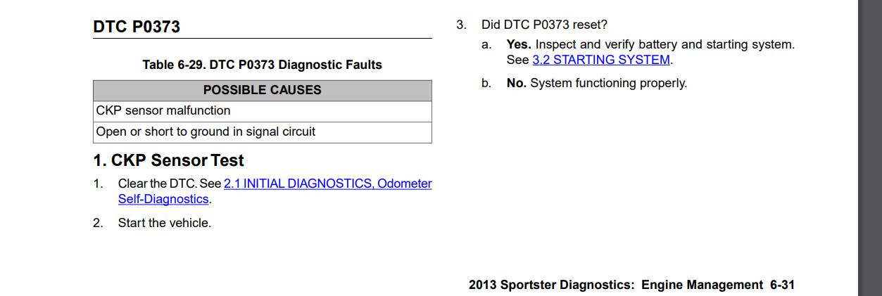

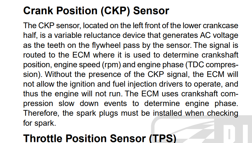

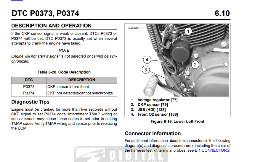

The CKP tells the ECM the engine is rotating, if it doesn't see the signal it opens the coil circuit on the System relay and you lose the fuel pump, Ign, and fuel injectors. The test is below and you might want to pull it and make sure the tip is clean.
