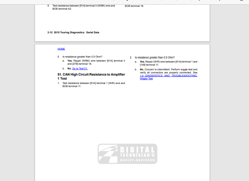

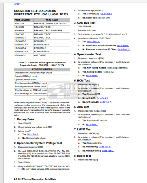

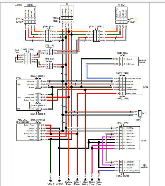

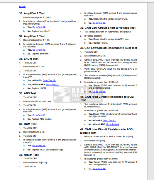

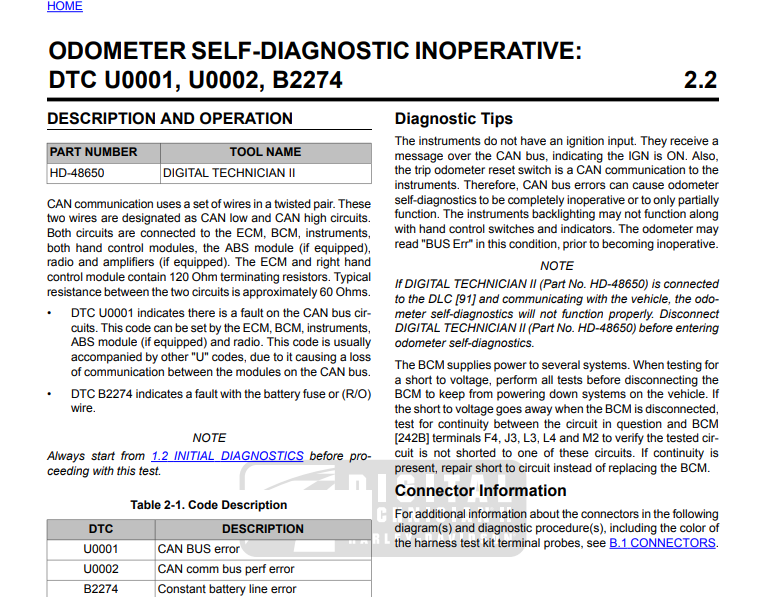

The ones in the Electrical Diagnostic Manual.

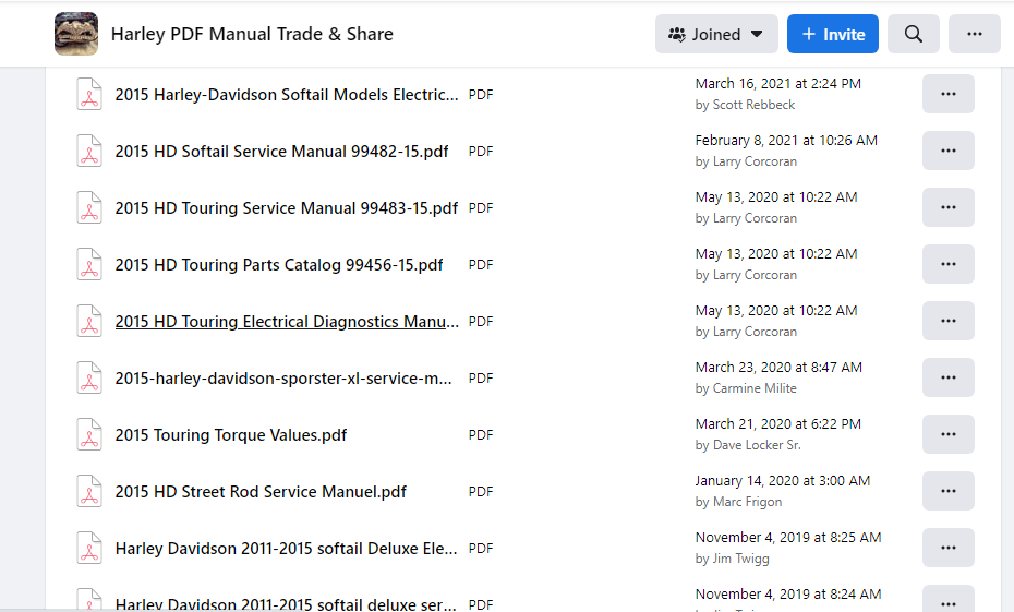

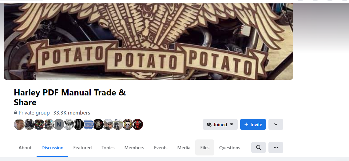

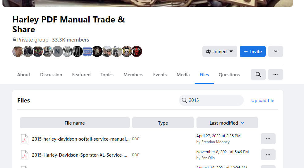

Go to this Facebook group and join, then click on files and search 2015. Scroll down and download the EDM.
Here's a few pages
FB Group
