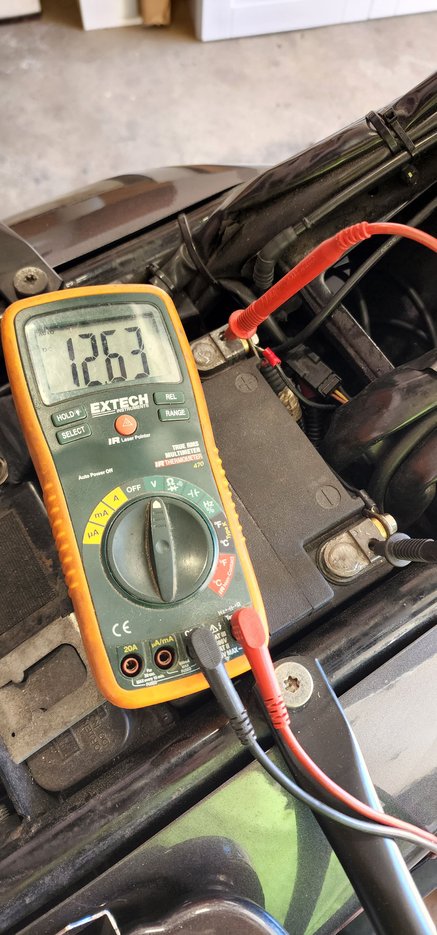

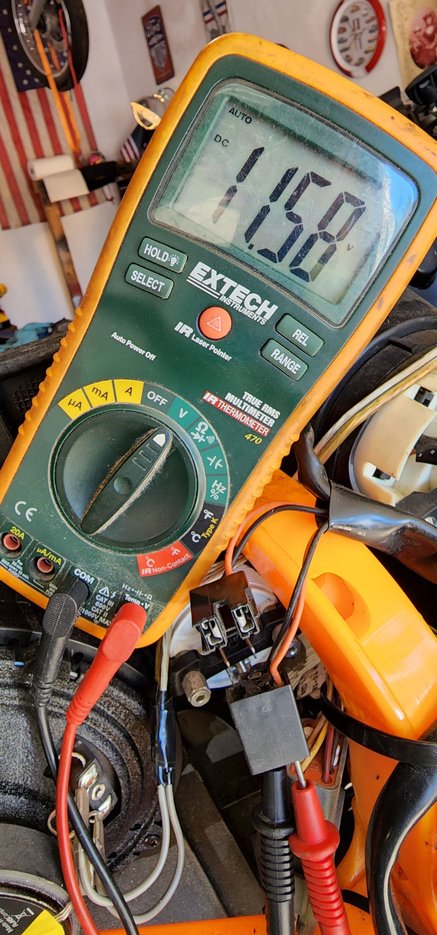

Old Aug 13, 2022 | 09:39 AM
Threeleggedog's Avatar
Threeleggedog
Joined: Apr 2022
Posts: 63
Likes: 15
From: Boston, MA
Default Bike off. 1volt drop.
At battery
At volt meter.
Old Aug 13, 2022 | 10:13 AM
Rounders's Avatar
Rounders
Joined: Mar 2021
Posts: 18,531
Likes: 3,744
From: backwoods
Try reading + at meter and then - at battery. Curious.
Old Aug 13, 2022 | 10:25 AM
Threeleggedog
Joined: Apr 2022
Posts: 63
Likes: 15
From: Boston, MA
sorry, not following. Read positive at battery and neg at meter and vise versa?
Old Aug 13, 2022 | 10:38 AM
Rounders's Avatar
Rounders
Joined: Mar 2021
Posts: 18,531
Likes: 3,744
From: backwoods
Put your negative at the battery, and postive at plug for meter. I think will tell you if ground bad. Can try reading the other way too. postive at battery, and negative plug for meter.
