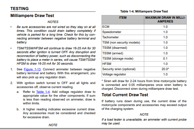

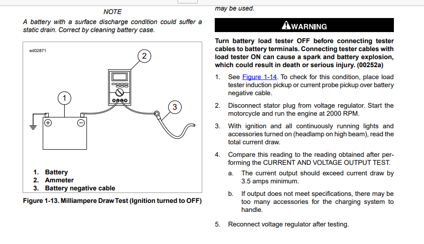

If the charging system looks good check for current draw while the bike is off.
