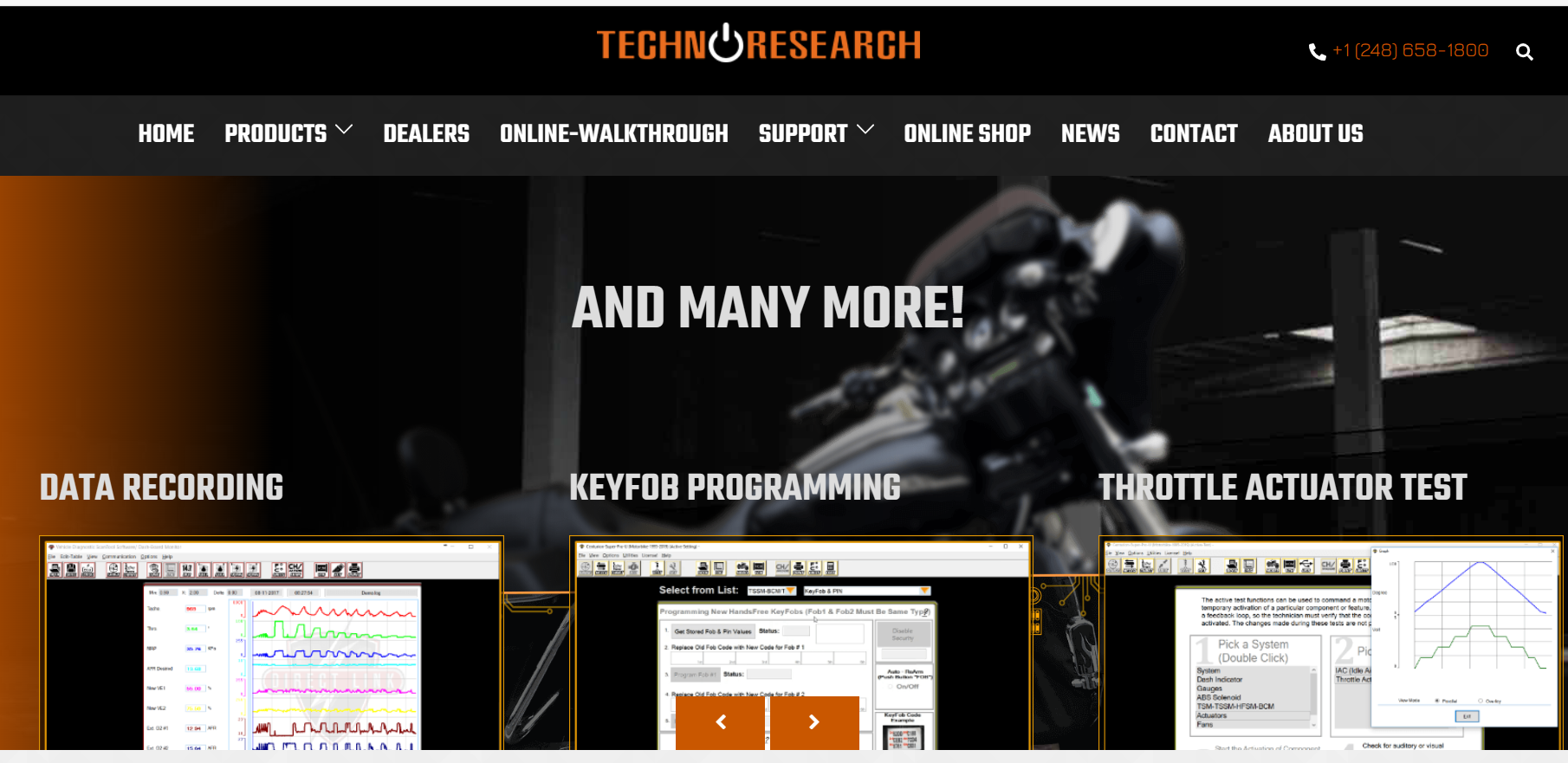

Give these folks a call and see if they think their product can help you. If so, then ask if they know a shop near you that uses the programmer.
