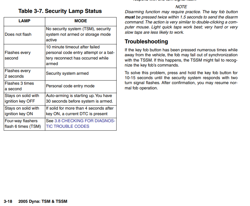

This is from a Dyna EDM:

Odds are holding the button as I advised will do it. My hopes of a resolution reply are low as I have not seen him back and I sent him a PM.
