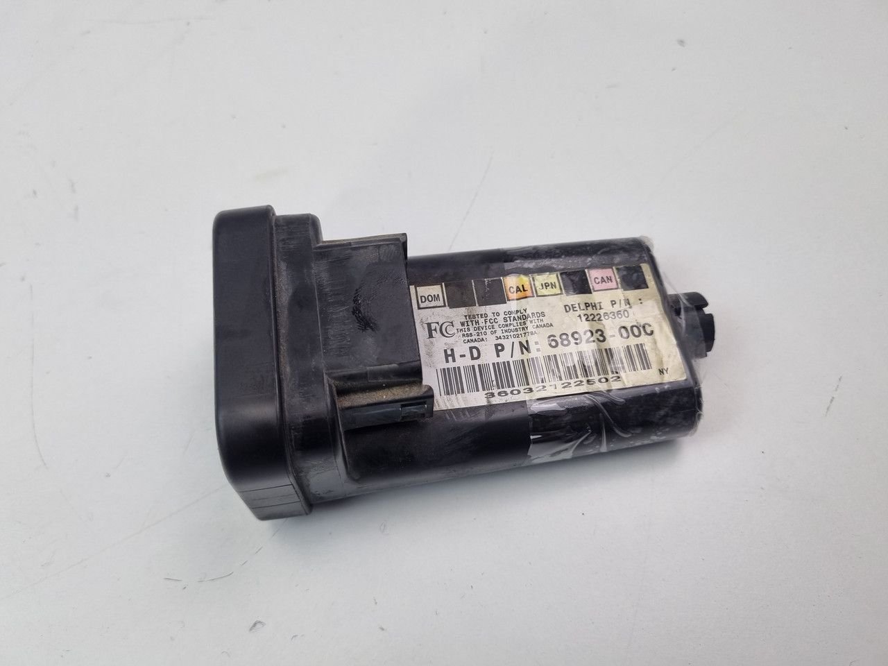

Turn Signal Module on the Softails of those years is located behind the rear fender plastic part inside the swingarm. You better raise the rear to have access to the two lower mounting bolts and then slide the plastic piece upward to take it out. And you must see the TSM (and some other electricals as far).
The TSM from JP with two connectors appears to be a wrong part. There is no that easy now to have a new TSM as they are discontinued.
Harley TSM looks like this
