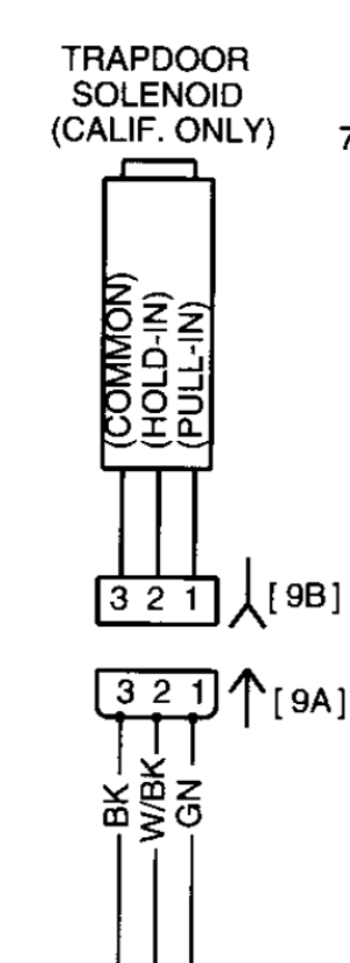

I have a 1998 hd FXDWG and under my gas tank, there is a 3 wire (green, white & black, black) harness connector that is not connected to anything. Just curious as to what it goes to. Please help. Thank You!!

IF everything works on your bike, then most likely something aftermarket was hooked up. Maybe a radio.

^^^There you go^^^
CA model connector, if needed.
