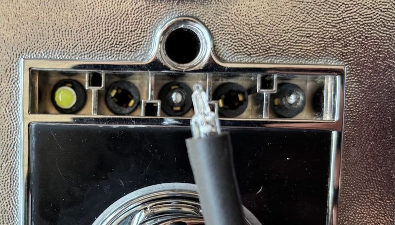

1998 Softtail Heritage Classic. Dash lights (turn, neutral, high beam, oil pressure) all seem dark. They light, just not enough for me to really recognize without significant effort. I'm doubly confused on how to remove. Manual doesn't explain how, that I can find. 3rd party vendors all lacking something close. Not even the almighty youtube is lacking specifics here.
is the bulb replaceable? Or is it an assembly that somehow force fits into the housing? Or other??
underside
underside
with legend removed to expose top side
Remove bulb so that the rubber press fit can be pulled out the back? If so, how to remove the bulb as I am having no luck pulling one out
Any suggestions or ideas?

Good news! #74 bulb it is!!! I went cheapo Amazon just to prove it viable. Bright white(6500k advertised) and it looks very promising when lit up.
And now the not so good part....
1) Removing bulb - don't use pliers as I got lucky with first bulb. They crush when least expected.

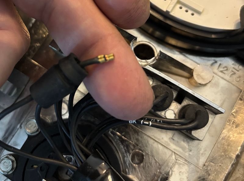

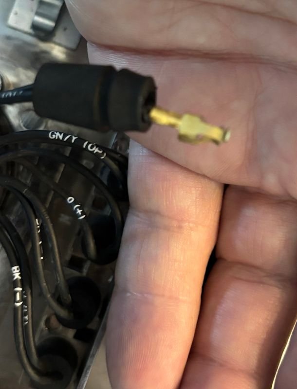

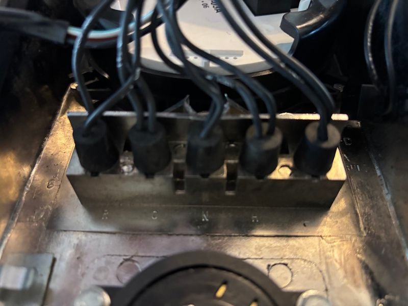

2) These specific sockets are press fit rubber. Do NOT twist. use a light oil and push from top down carefully with finger, not tools. Because....
uh-oh
uh-oh
this sucks
this sucks
the good side making connection with bulb

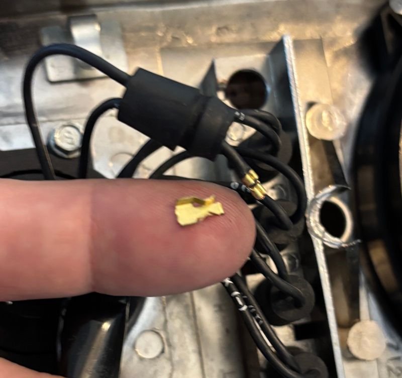

3) LED's I got are polarized. Meaning they only work one way. I was on the last bulb (right turn indicator) when I couldn't sort out why it was not lighting up.
This is the same one that I tugged, twisted, pushed with a blunt screwdriver to get out of housing. My fault,
Now to find either the socket for pilfering parts, or the connector itself or the whole rubber socket/harness (not looking good at this moment).
One step forward, one step to the right into dog sh@#..

Originally Posted by Illinois_Minion
Now to find either the socket for pilfering parts, or the connector itself or the whole rubber socket/harness (not looking good at this moment)..
The p/n for the socket is 67184-94. There are some available at Ebay right now or try to get the socket at a motorcycle salvage company
