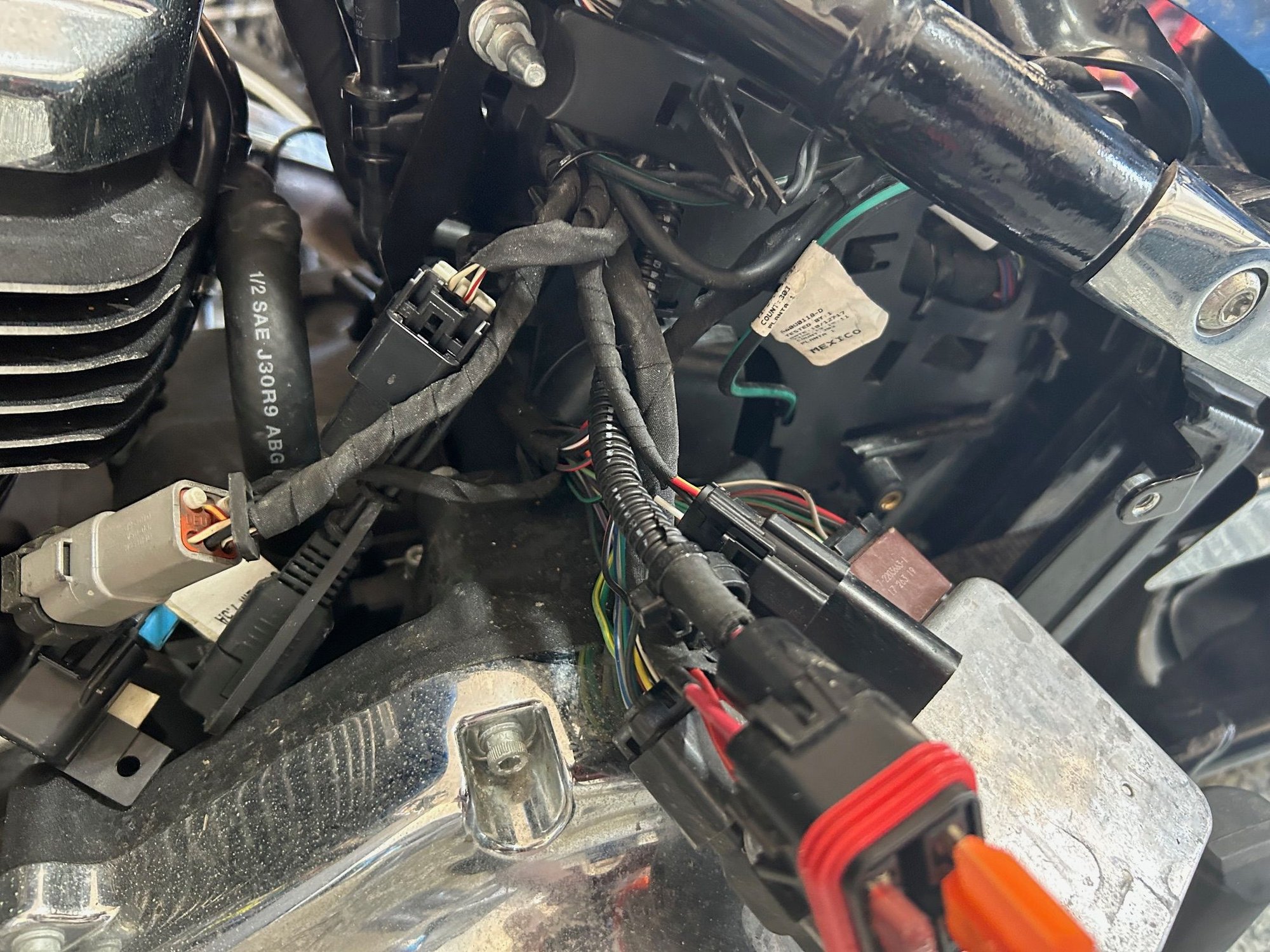

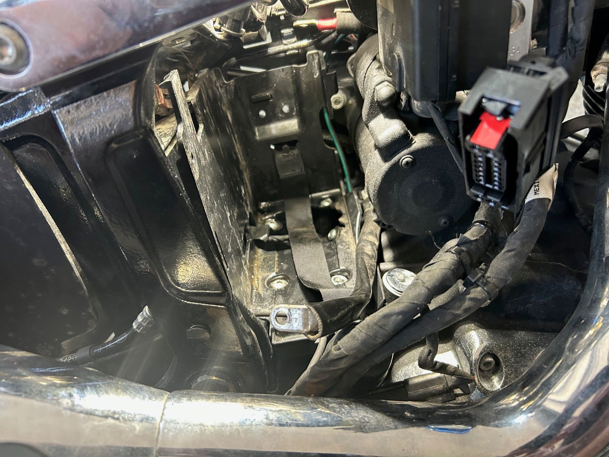

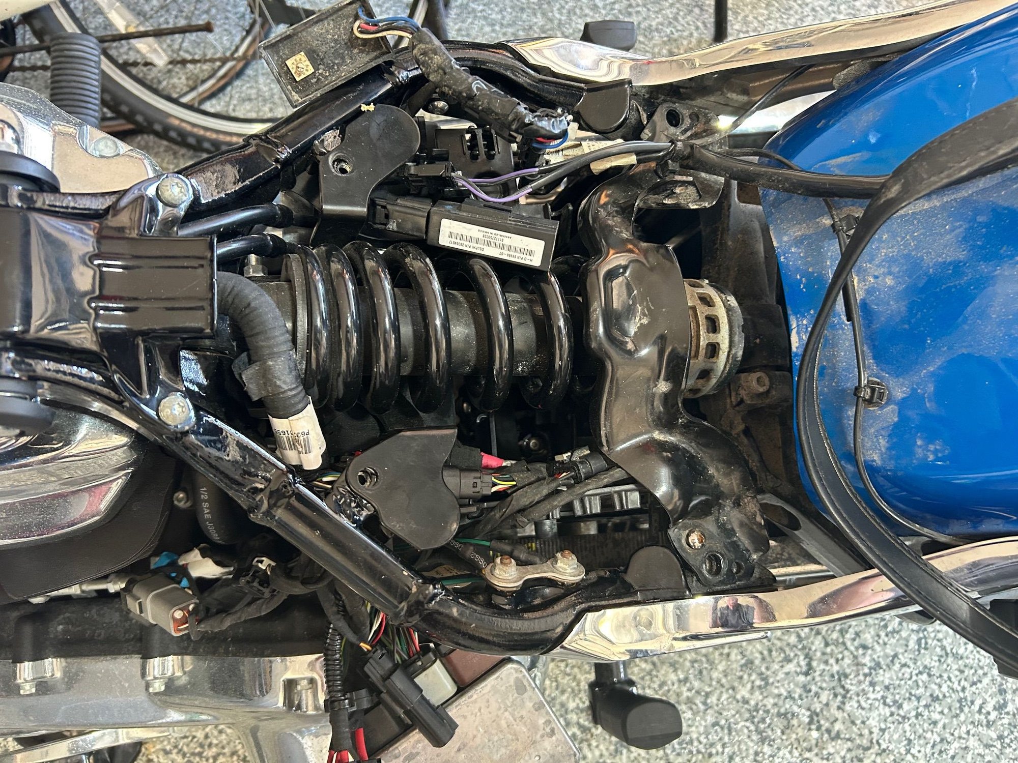

Problem I have is I found the one big Fuse with the two little ones mounted on the left side (facing forward) under the black body cover. You can see it in bottom of 3rd) picture. However according to the web, , the You Tube video and the manual there is a second fuse box that has two relays and other fuses.
EVERY place I have googled, You Tubed etc... they all show the damn fuse box on the right side of the bike under the seat, in other posts they also say it is on the left side of the bike under the seat. I have literally stripped out the battery, and moved everything under the seat frame above footpegs and I cannot find the damn fuse box.

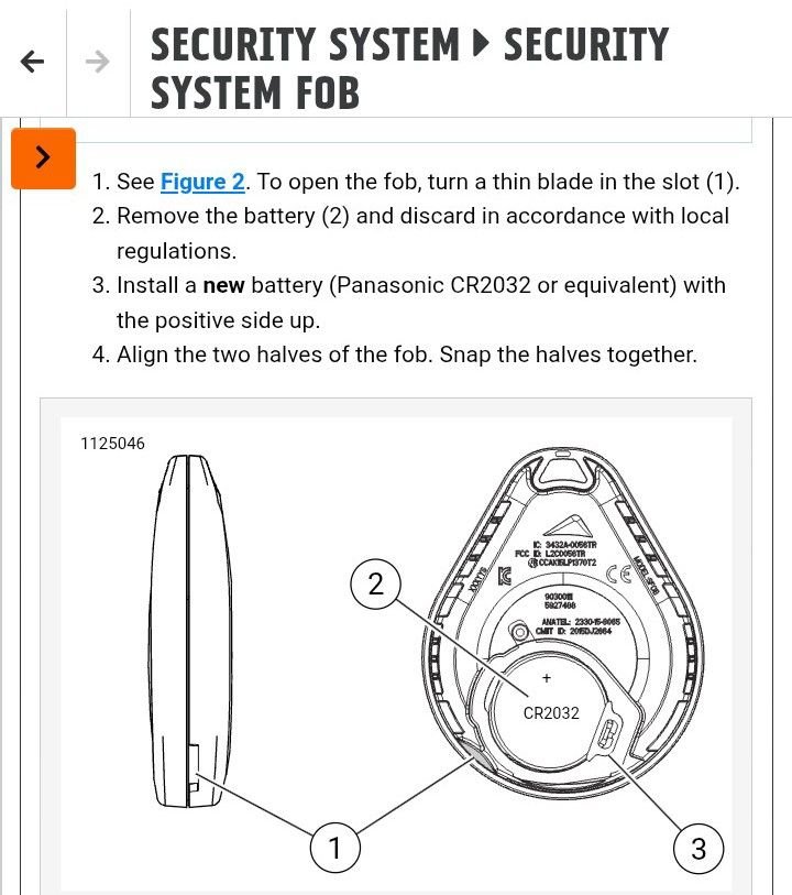

This might sound dumb but have you changed the battery in the FOB?

Hi not a stupid question. Since the bike battery died, I assumed the battery in the FOB died as well. So I replaced it with a brand new one. Same result. I even tried the second new one (had to buy in pairs) - and nothing.

Why are all those wiring connectors pull out with most looking like they are disconnected?

Hi guys thanks for feedback. Tested the battery - she is fully charged. Now the 40 amp I did not test, I looked at the filament and it looks good. I am going to try that. Galv Tex Guy, All those wires clip to wires and the cable mounts on these plastic inserts. I had to pull them off to remove the plastic inserts to look for the second fuse box.

This might sound dumb, but chech to see if the fob battery is installed correctly. Occasionaly people have installed the battery upside down, The positive side goes down.

There is no second fuse box on an M8 softail. The one fuse box there on the left side of the bike with the main fuse is the only fuse box on it.
According to the Owner's Manual, the positive side goes up.
