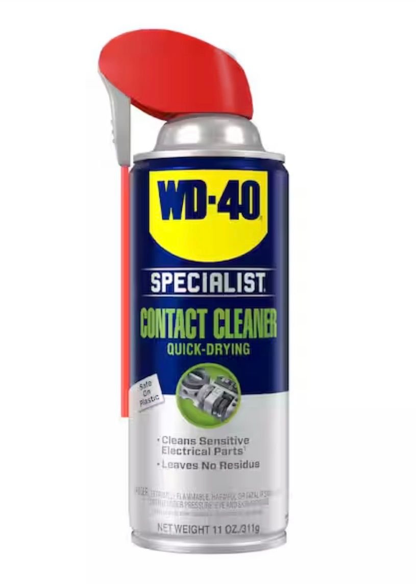

I probably shouldn’t have been surprised with how dirty it was when I pulled it all apart. With how messy oil changes can be sometimes. I sprayed it all down with this expensive stuff. I hear you about the brake cleaner. Some say it doesn’t damage powder coat either but I think it could.
