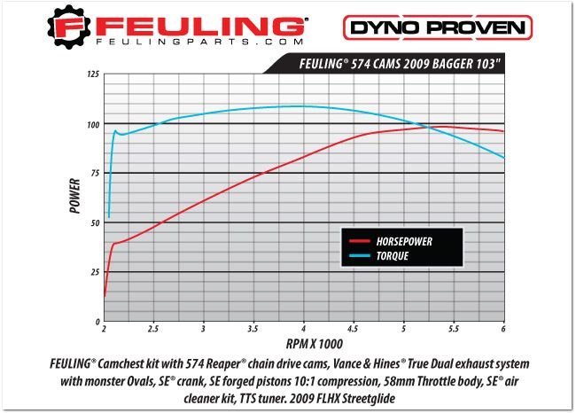

Originally Posted by prodrag1320
the fueling .574`s,set at 10.5-1 would be a good choice.
Kirby,
Is this not comparable to what I already have? I am set at 10.1 and this graph shows 10.1.

Looking over ( dyno runs) of many different cams i would call most of them comparable. The only cam i didnt see any runs for is the woods 999, but i dont think its what you are looking for. Calls for 10.5 comp. and the usaul other mods, but for the bike to come on at a lower rpm dont we usaully have to give a little back up top? Maybe a lower tooth drive would put you right where you want be, if possible for the fxsb.
