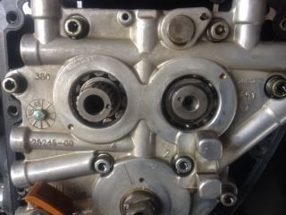

Did the leakdown test, 0 leakage. Went into the cam chest and this is what I found.
This forum is the best and I appreciate your help. Nice having a garage again so I can avoid stupid mistakes like this.
Time for some carb tuning now, might be a little lean. But is sure is nice and smooth with the extra power.
