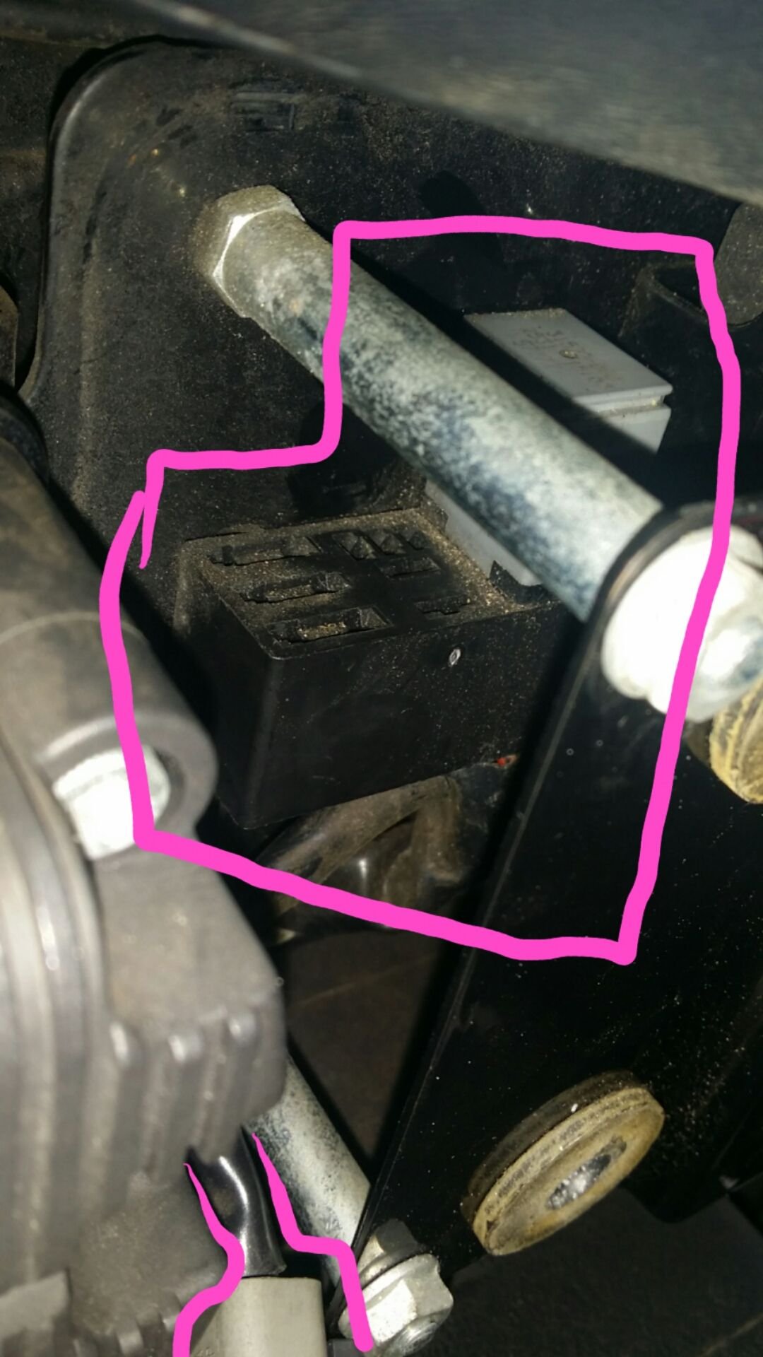

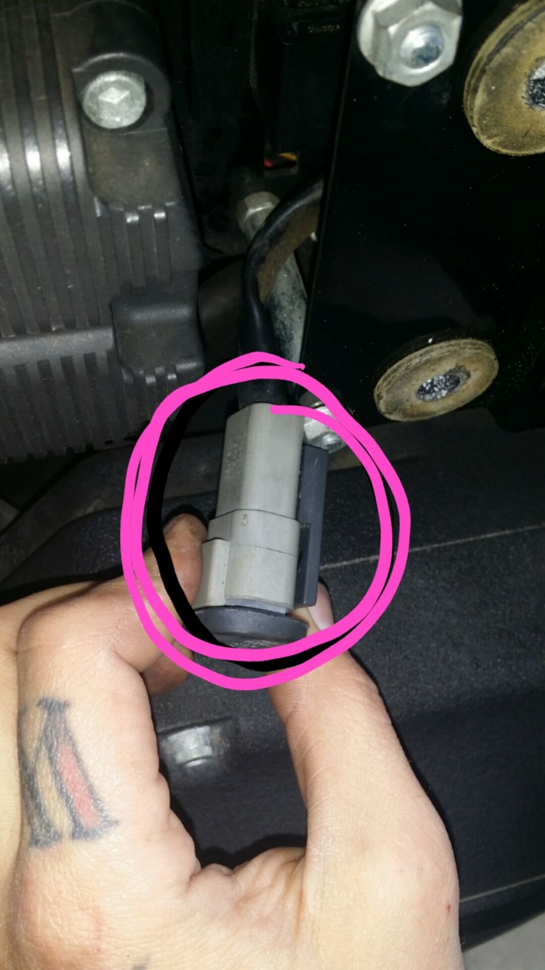

Just got home after being stranded for about an hour. 2002 fxdx. Picked it up last weekend. Took it out for a ride, got it back to the garage, tried to start it later and click click click. Would not start or turn over. I messed around the area In the pictures I included and it finally turned over. Today it happened again. Went to get some air in the tires, turned it off got air. Went to start and click click click. Again I wiggled around in the area in the pictures and it finally turned over. Very frustrating as I don't know exactly what it is. Thanks.

These problems can be maddening. First pic is the starter relay. They go bad and are cheap to replace. Replace it and buy a spare while you are at it.
Second pic is the diagnostic port to read codes/reprogram the ignition. Pull the end cap off and clean the connections inside with electrical contact cleaner and replace the plug. Check the wiring to make sure that there are no tears in the insulation that could contact a ground. Probably not your problem, but check it anyway.

Before changing things on a whim, Get a relay fr later, and ride it. When it happens again, and you hear the dreaded click, try tapping the relay while holding the start button down.
And make sure your in neutral when you do. If it energizes the starter then you KNOW that's it. THEN replace it.

Still guessing. And that's why I said get the relay. So when it happens again and if that was it after confirming it was actually it. He could change it on the road. It's not that difficult to access.
But I guess changing an $8 part that may not need changing is how you fix things.
Hey how about this, starter could be bad, battery may be weak or failing. Lets change those too.
