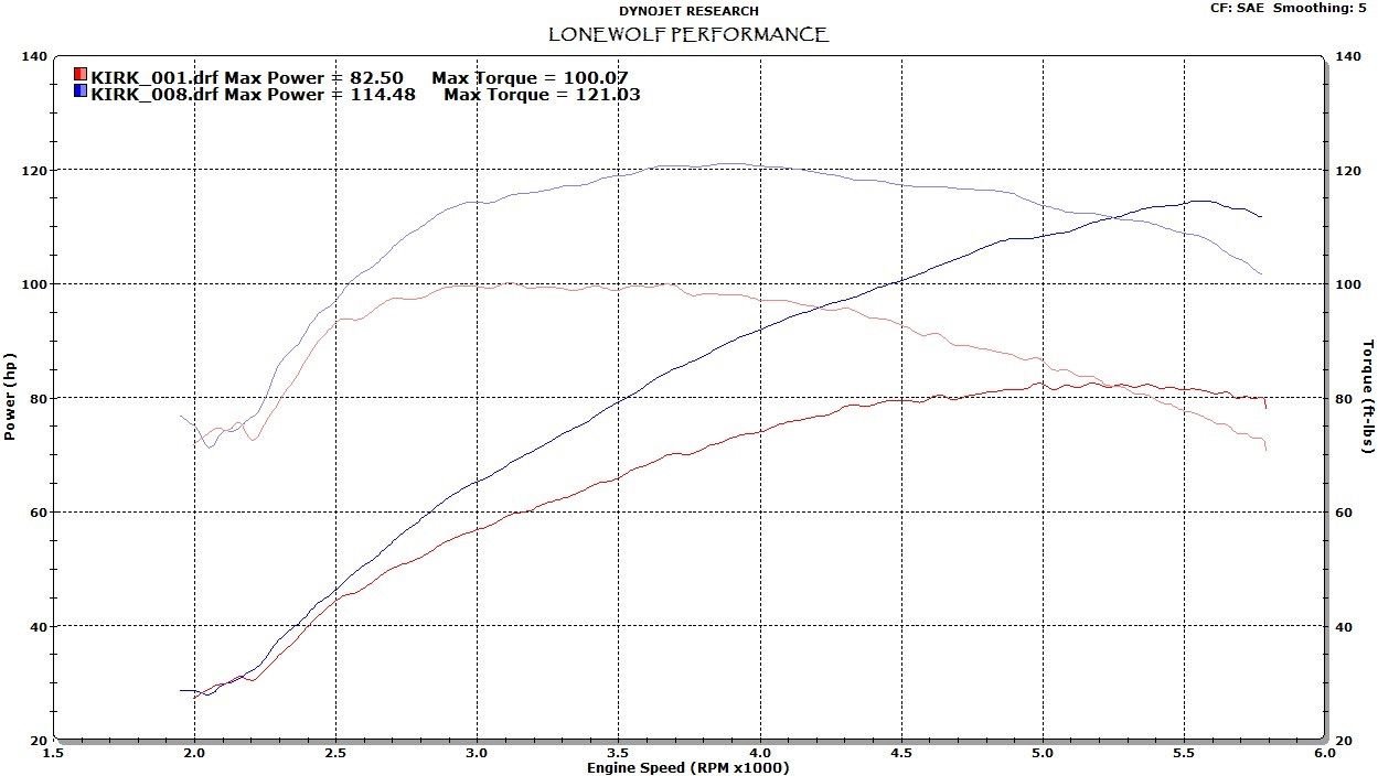

I have a 2010 SG and put in the Head-Quarters 107 kit last September, it comes with the HQ-TC-575 cam. It dyno'd (SAE 5) at 114.8 HP and 121.4 Tq, VERY pleased with the results.

RottnRam, here's the Dyno of my Head-Quarters 107 build. The 'before' numbers are from a 255 cam and 103" upgrade kit the dealer put together when I bought the bike with the added SE Heavy Breather, a Drago's Dragula 2-1 exhaust, and a PowerVision tuner from Fuelmoto. On the recommendation of my builder and tuner (Lonewolf Performance) I added the HQ-107 kit which included reboring the jugs (had them port the heads at the same time too) and the HQ-TC-575 cam, compression is 10.5/1. The bike now has plenty of giddy-up and is a blast to ride.
Looks good and thank you for the dyno and specs
