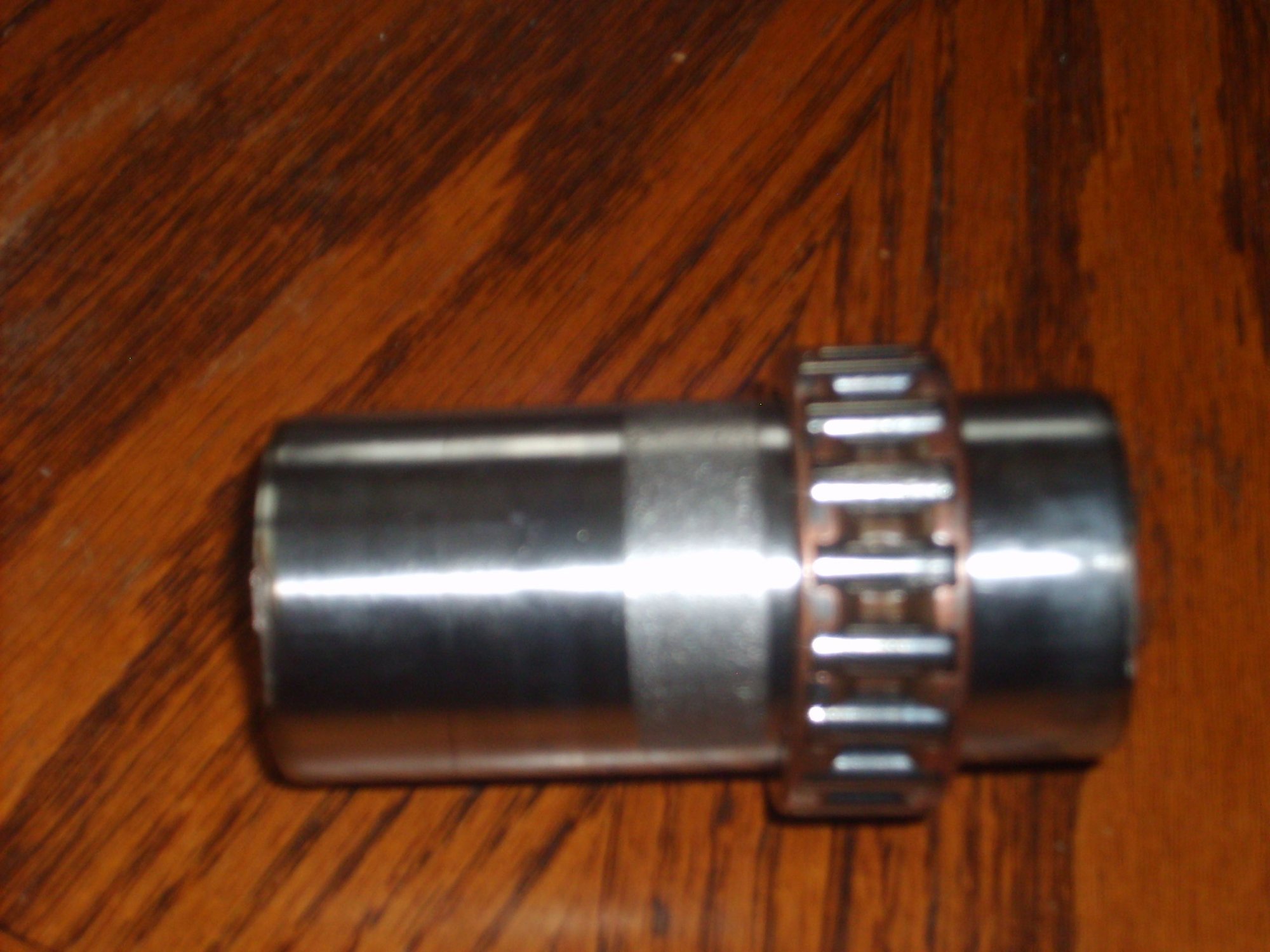

I was talking to John. He was really concerned about my deck height. I kept telling him that it was stock down there. Is there something about stock setup in the piston and cylinder that is inconsistent that he would be asking me about that? The only thing about deck height that isn't stock is the fact that they use rods that are 0.003" longer than stock but he knows that. Anyhow, here is a picture of the crank pin. it is about 1/3 of the way around it and about 3 or 4 bearing rollers were also rough. The rough spot feels about 0.010" deep or so. I will take it to work and get the metallurgy guys to tell me a better story of what failed.

Very Interesting thread... Subscribed......keep us updated .... Thanx..
