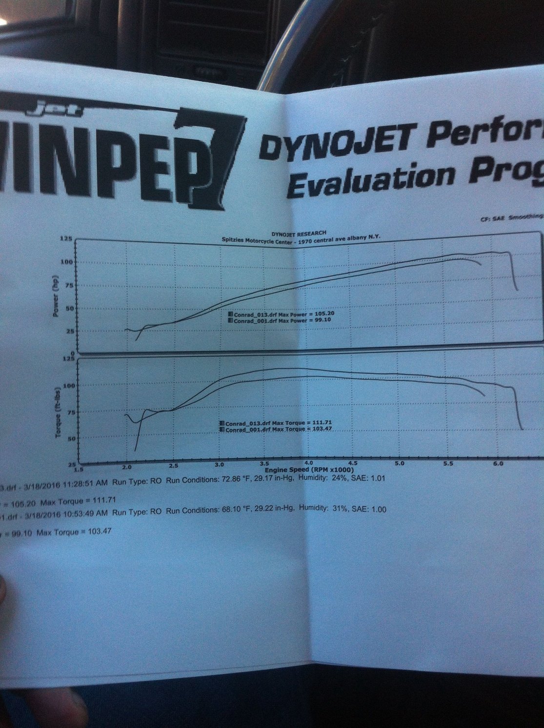

Originally Posted by 15 flhx
just to let all know I did this build the way I said I was going to do it ..I did put the heavy springs in the heads and seals with no head work ..I did put the 58 mm on with 259
cams and 10.5 to 1 screamin eagle pistons and im very impressed bike runs great and is very strong ...my numbers are 105hp and 114 tq ....I did this build very cheap because im a shopper and I do my own work.... very little money spent with great results
Not buying it,lets see a chart

105hp with stock heads... I'd like to see the chart too
You might want to buy it
chart is up..

the only thing done to these heads are the springs to support the 259 cams and that is it ...
take a look ...and its only a little 103..bigger is not always better boys

I must admit that the peak TQ number is a surprise and the curve after 3000 rpms is not bad but 100TQ between 2500-2800 rpms on a bagger is more to my liking; JMHO. The low HP number is not a surprise though. The OEM heads cannot take advantage of the potential HP to be gained from the higher lift cams and the larger T/B; although the larger T/B may be the reason for HP breaking 100. My point has been more "why bother" with cams and larger T/B which are designed to deliver HP but fail to take advantage by running OEM heads. I would expect to see HP numbers in the TQ range with head work and perhaps, a marginal increase in TQ, or at least moving the curve to the left a bit.
I just don't see the point of upgrading to a high lift cam and larger T/B and retaining the OEM heads; however, if 15flhx is happy, what I think doesn't matter.

Good job,
my first build with stock heads did 98/115, it's rare for (near) stock heads to get over 100hp.
Earlier torque would be better though, mine is making over 100 at 2200.
