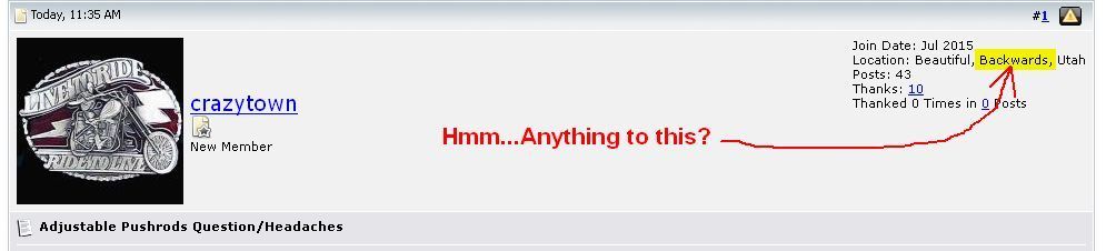

Old Apr 13, 2016 | 04:12 PM

em ot esnes sekam lla ti woN
oot em dna

LOL!!!!!!!!!!!!!!!!!!! Wow, I just have to plead ignorance I guess. Thank you everyone.
@multihdrdr your post made me snort laugh.
