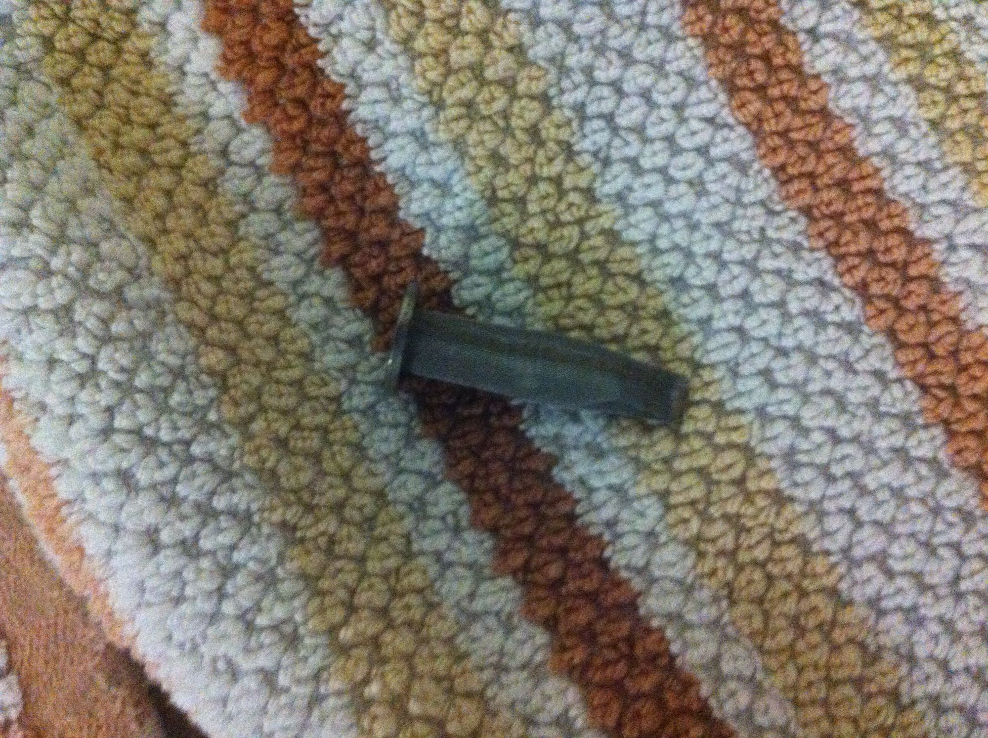

I'm in the process of a Fuel moto 107 Kit and while I was removing the cam plate this filter screen falls out. I did not see where it came from. Anybody have a clue????? Now the upper brown 'O' Ring was stuck on the gasket when I pulled the plate off, does it slide in the hole behind the 'O' ring?

If the oring stuck to the plate it was behind the oring.
http://partsfinder.onlinemicrofiche....b=8&c=0&d=2008 FLSTSB SOFTAILŽ CROSS BONES™ (JM) CAMSHAFTS ASSEMBLY W/ CHAINS

Thanks for the assembly print.I could not find one.

That is also known as the witches hat. Glad you got it handled!
