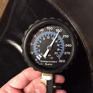

Front cylinder was right at about 180, and rear about 185. Whenever I see someone post their compression readings, they're generally 200-210. Is that unusual?

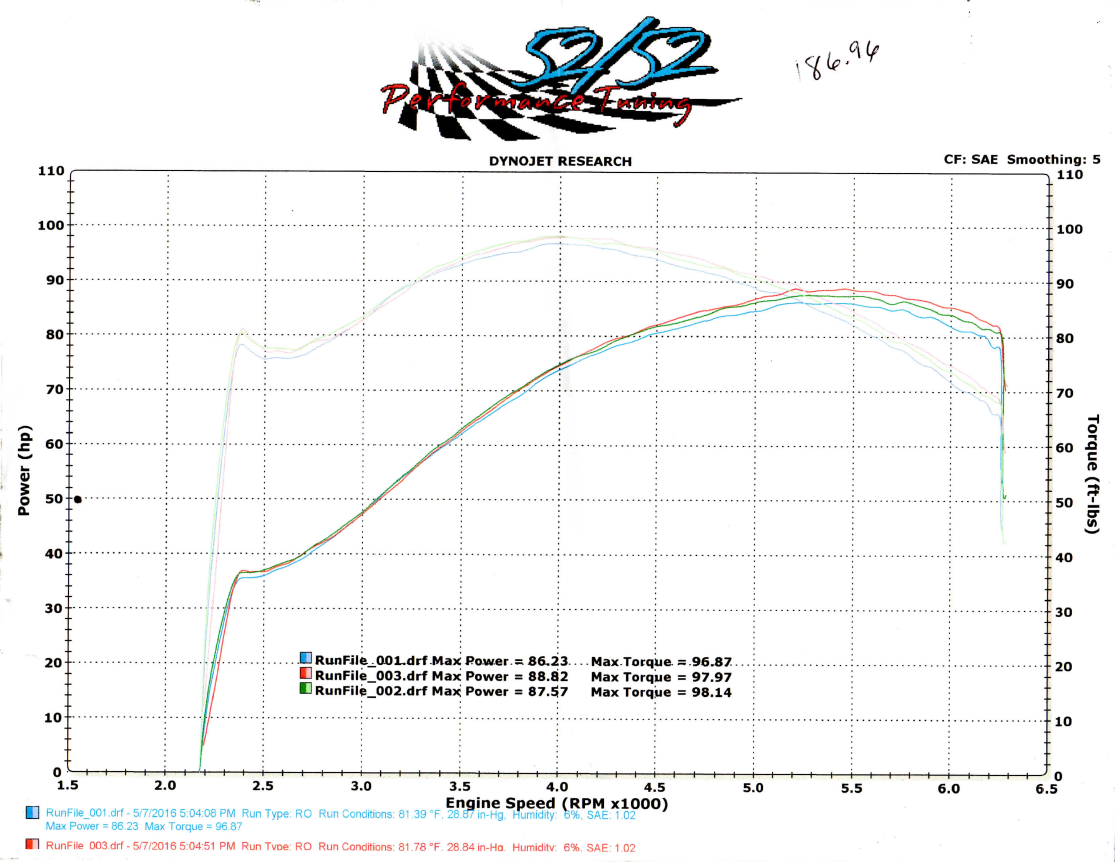

To add a bit of backstory, I've never had a proper dyno tune on the bike. I'm running a Thundermax, and while the bike to me has always run really good, it wasn't putting out the kind of power I expected. I ran it on a dyno once at a local bike event and it maxed out at 88hp and 98ft-lbs torque, which is less than I was expecting. I've also been getting some pinging on heavy throttle, which I've maybe improved a little bit by playing with the timing, but I really need to have it tuned professionally, and I can't find anybody around here that will work with a Tmax. I've been seriously considering switching to a different tuner, but that's a different subject.
To recap my engine setup: '09 96" with a 103" SE piston/cylinder kit, Wood 555 cams, WFOLarry Stage 1 heads w/stock valves, .030" head gaskets, D&D FatCat pipe.

If you are running flat top pistons with that build and Larry didn't whack much off the heads, 185 is probably close..
On the Dyno I used to use your HP and tq numbers are probably not that far off, especially without a tune and it looks like both the dyno and bike may not have been completely warmed up.

I thought about it after my earlier post regarding compression, makes sense since mine is essentially a stock 103", and most #s I probably see listed are for performance built 107s or bigger.

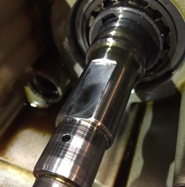

Finally had some time to pull things apart. The oil pump and the bushing on the cam plate look fine to me. The crank runout is about .004, which is where it was when I checked it a few years ago.
Looking everything over in the camchest with my untrained eye I don't see anything unusual. Very minor scoring on the end of the crankshaft snout, goes a little less than 1/2 way around, but smooth enough I can't catch a fingernail on it.
I kinda assumed I'd see something apparent, and now I'm not sure where to go. Could it be a bearing issue? I wouldn't think roller bearings would make noise.

Take pic of the end of the crank and the cam chain sprocket hole.
