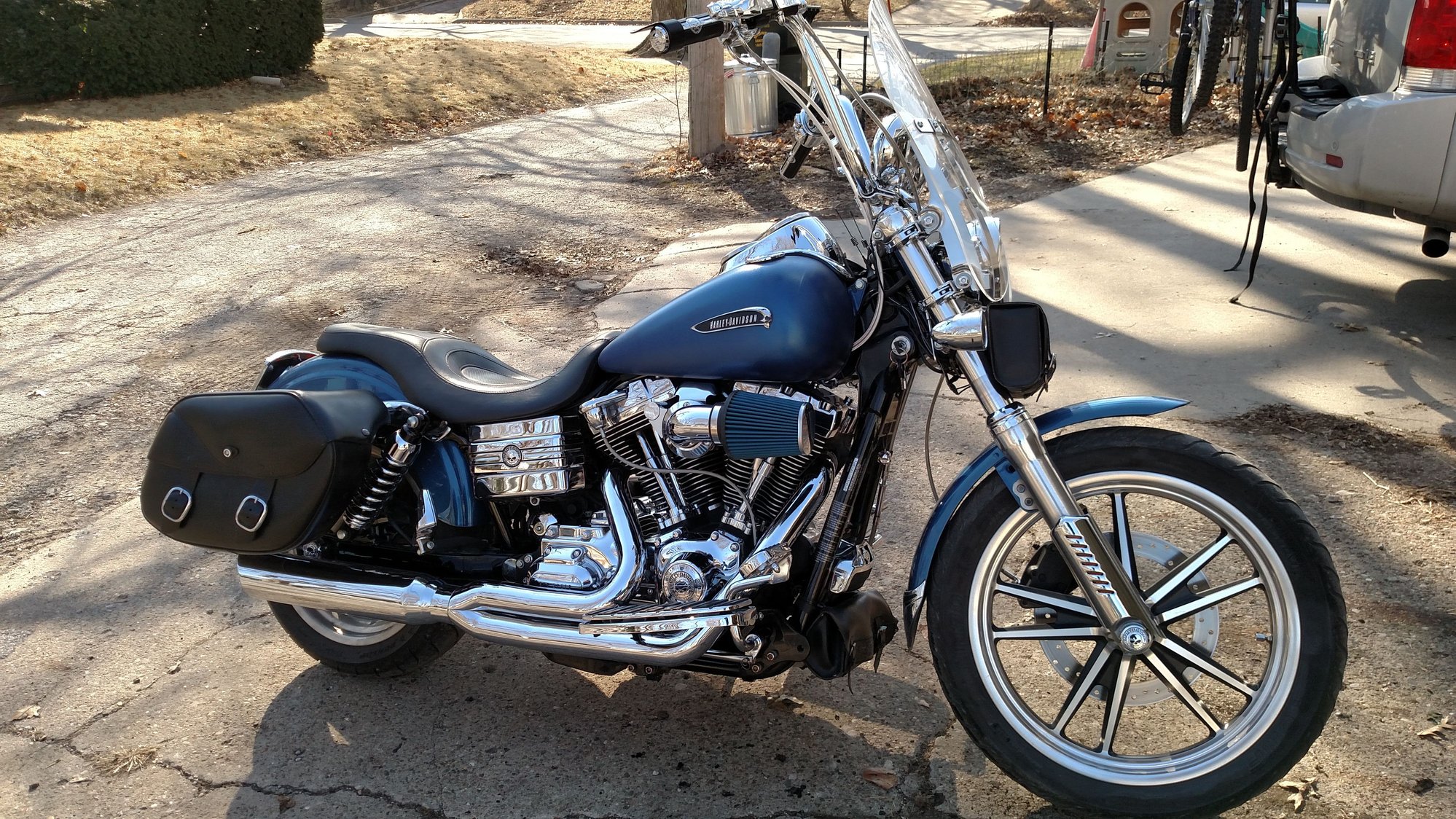

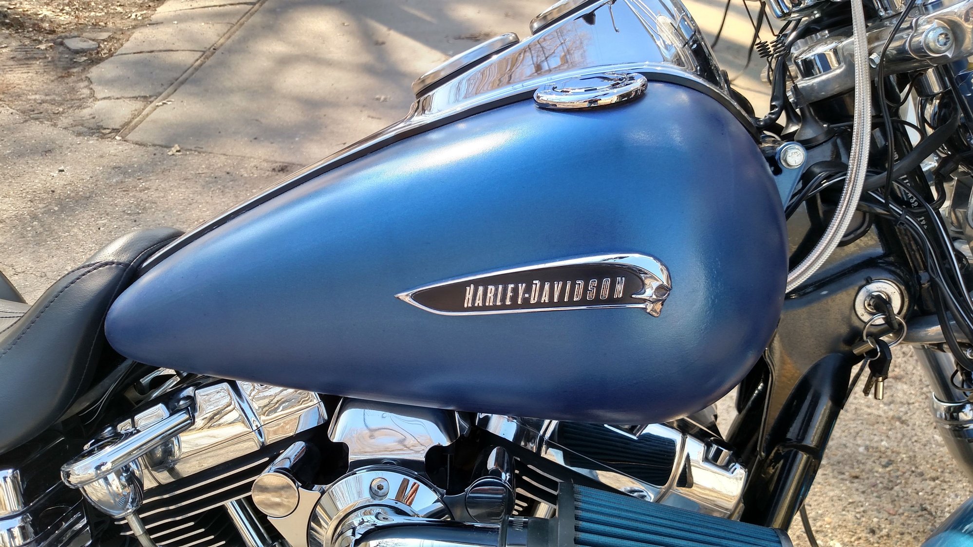

So did the paint on the tank yesterday to finish off this winter build. Also increased the open loop to 14.2 in the cruising areas due to some excess decel popping while cruising and decreased the top end over 80KPa to 12.8 because it seemed a bit sluggish after initial the initial surge on high throttle.

Clean looking..... Nice job man.......
