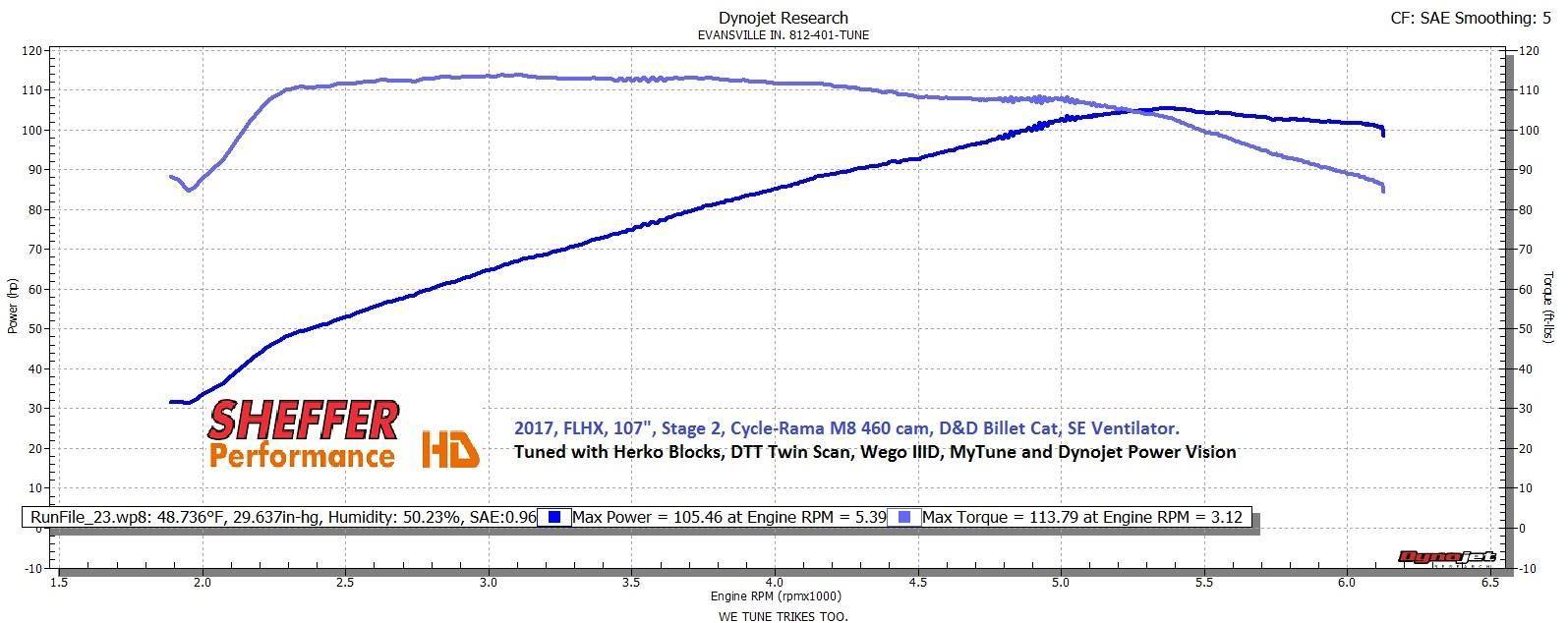

I don't want to sound like a parrot, but color me impressed with Cyclerama's offerings. It's amazing what kind of power these M8's can get, with a simple cam change.

Then again, this ain't too shabby, either... But, if it were my money, I think I'd go with the cr-450's and be done.
