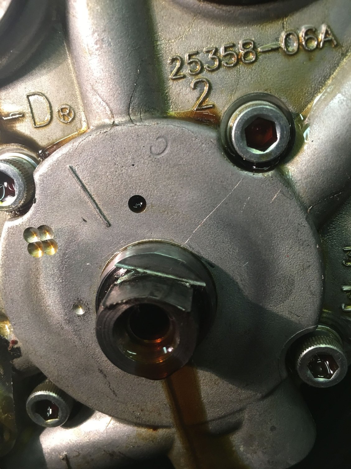

Found my noise! Can't upload a video but looks like the loc-tite in the crank gear bolt didn't hold. Gear is roating about 20-25 degrees on the cranks. Probably not clean enough. Total Fxxk up on my part! For those that don't know, the gear is MUCH harder than the crankshaft! Only fix now is a new crank or a new motor. Sucks to be me!

Compensator nut? Post video or some pictures; maybe all is not lost.
I would bet pinion sprocket..
Yes, my bad. It is the pinion sprocket on the end of the crank.

Ouch! That's ugly!
You win! Looks bad, no?
