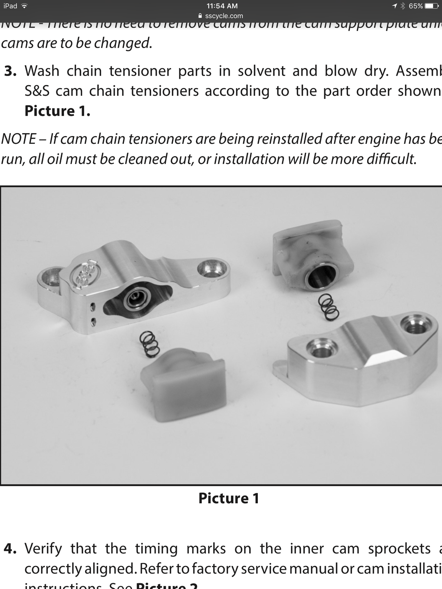

48,500 miles on my Streetglide,outside cam chain tensioner wore completely out,came apart spring got sucked into pump and destroyed it.
Just a heads up for you guys.

'07 should have hydrolic tensioners, stock from factory; not springs. Have pics?

There is a small coil spring under the shoe

Oh, that little spring. Bummer. Hopefully the oil pump is the only part affected and you can get it back together inexpensively.

I was surprised that the shoe was so worn at that mileage ,I was not tracking at all that there was still a problem.Ther was a hole in the surface of the shoe,I guess that's how the spring escaped?
