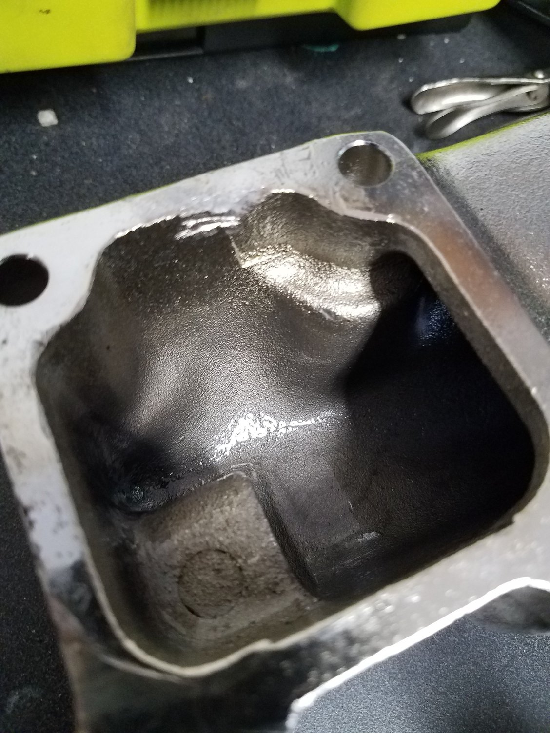

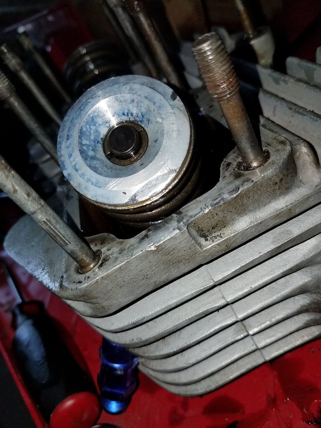

Found the problem. Bought new rocker covers(drag specialties)and the casting is bad. Valve retainer hits the casting. A little grinding and a new retainer and it will be good to go. Going to pull the front off to make sure nothing hits there.

Looks like someone installed / removed the left rocker cover stud with a pair of vise grips..

I imagine in the 30 years before I had the motor there has been a lot of that.

Yeah,, You can tell the guy that owned it before you was a hack.. Gasket surface was chiseled at. I gave up on trying to find an oldie to restore.. Better to use new cloned parts.. Less chance of someone messing them up, tho they can have their own issues like your valve collar clearance issue.. I've made that mistake putting together an old round cylinder B44..
Good find. A little die grinder work and you're good to go.... would love to hear a sound bite once you get it all straightened out... good luck man....
