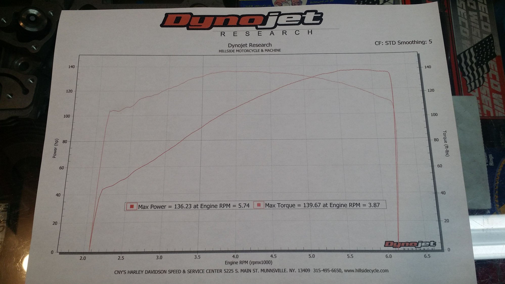

117", our CVO 110" Heads, 64mm, Wood 9F,
Bobcat........
Not made in China.
​​​​​​​Scott

Very nice Scott..... I wouldn't expect anything less.....

Boom........... That's got some sack!

Should be able to spin the tire, if wanting to.............
Scott

Nice lines nice numbers.
Cdonis if you're watching, the bobcat does well on the big motors if you were wondering here it is.

So for us dummies, what is a Bobcat?

Nice Work!
What is the Static Compression??
What is CCP??

Impressive!!!
A Rocket!
YB
It's a D&D pipe. Cdonis uses one on his 103"er
Originally Posted by FlaHeatWave
Nice Work!
What is CCP??
I would imagine with a 52* ivc it around 11:1.......
Personally, I tried to enhance a couple of his builds and failed..... My ride is back up there and this time it's gonna be his text book design... No more messing around.... His ability to match parts is outstanding......
