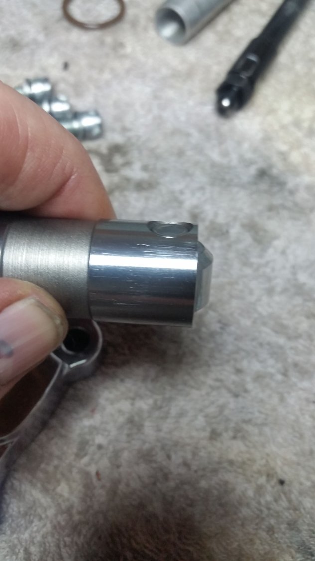

I've been all over the map chasing some valve train noise. It isn't excessive (sewing machine) and really only annoys me at about 3000 RPM.
Above and below the noise is *almost* inaudible.
I have adjusted the pushrods from the manufacturers recommended .104 to .145 and several increments in between with .104 actually being the quietest.
I'm sure I'm being obsessive as this is my first bike with a fairing and every little tap and squeak bounces off it. None the less, it diminishes my enjoyment of my riding time.
I have eliminated the possibility of a rod hitting a tube after 2 rounds of reaming (clean tubes with no marks what so ever on this tear down )and I have manipulated the tubes @3000 RPM with no change in the noise.
I decided to have a look at the lifters today as that is less invasive than pulling the rockers (again)
I didn't really find anything alarming that would lead me to a cause of the noise but here are a couple of pics so I can get an opinion from the experts here.
I did take a look at the stock lifters and the minor marks on the lifter skirt are present on those as well.
The line on the roller is only presentry on front exhaust lifter.
Any ideas?
Pull the rockers and have a look at the shafts again?
I did not note any witness marks when I installed the Rockouts.

If you have a youtube account post a video with camera one foot away at one cylinder for 20 sec then the other.

Thanks Dave, I'll try that when I get it back together.
I'm considering re installing the stock B lifters (17k) on them) just to eliminate it being a noisy lifter.
Otherwise I'm lookin at pulling the rockers.

Seems like you've already done plenty of labor in locating it without change. Some cams and/or lifters can have a ticky rpm area so could be normal operation. Or a different aftermarket lifter may be quieter. Video could help someone chime in on a fix if it's still there.

I put the b lifters back in. Noise is about the same.
