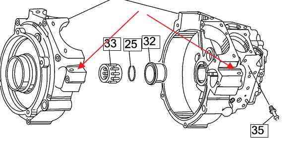

Pic show tranny and crankcase.. 3 1/2 in long bolts drop through these holes to connect the motor and tranny together.. Make sure they are tight.
