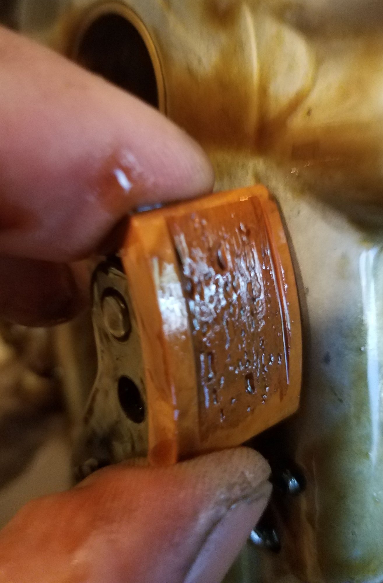

Nice ride. I too, have an 03 WG. It's done big trips, but now only does guys weekends out. Big miles done with 16 RGU. I just turned 30k on mine. Did hydraulic cam tensioners, and since in there did upgraded cam plate, timing chain and Andrew cam upgrade....with adjustable push rods. My tensioner pads were getting real bad. My commuter. And my 3 ladies together.
worn cam tensioner.
