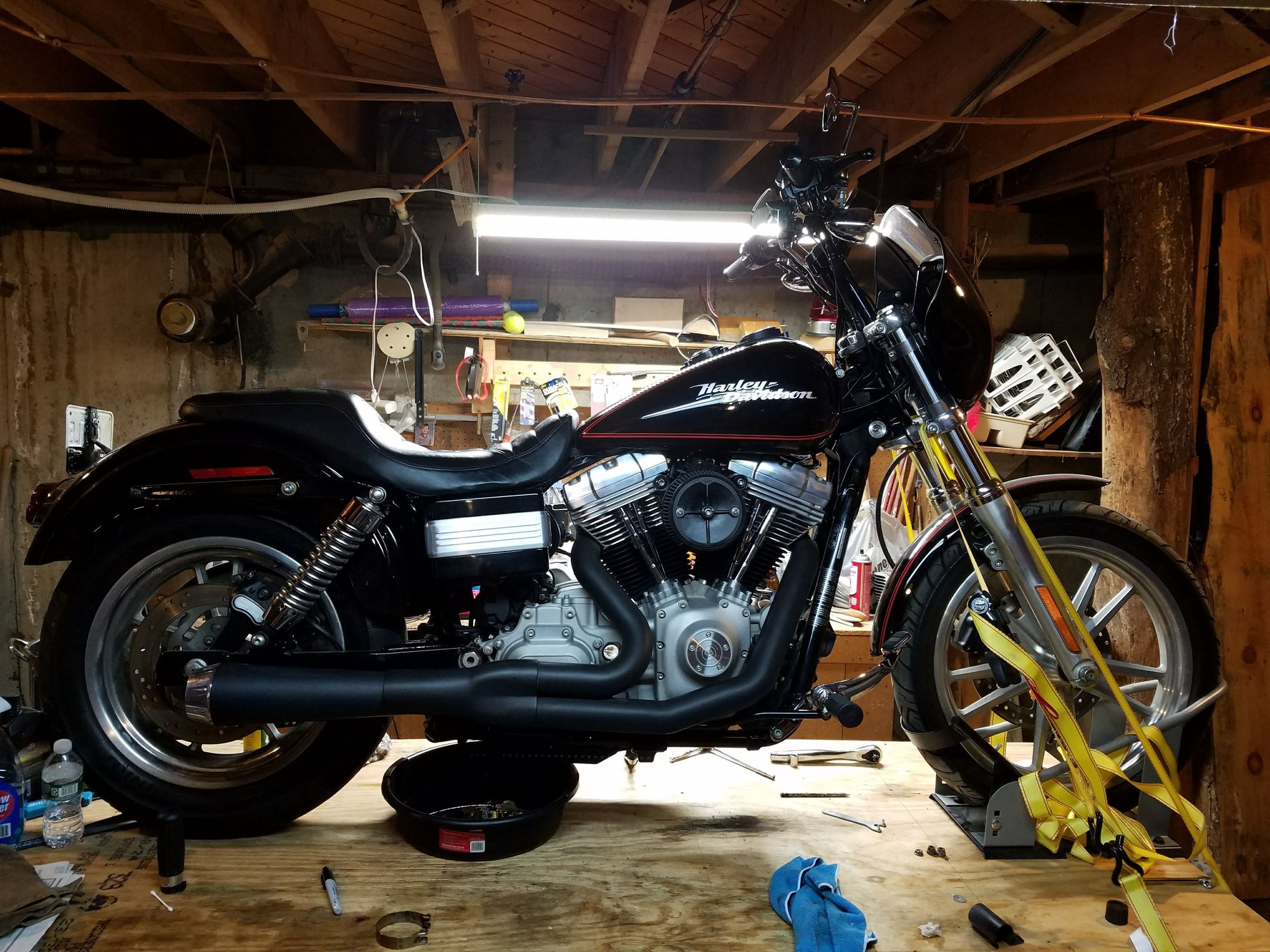

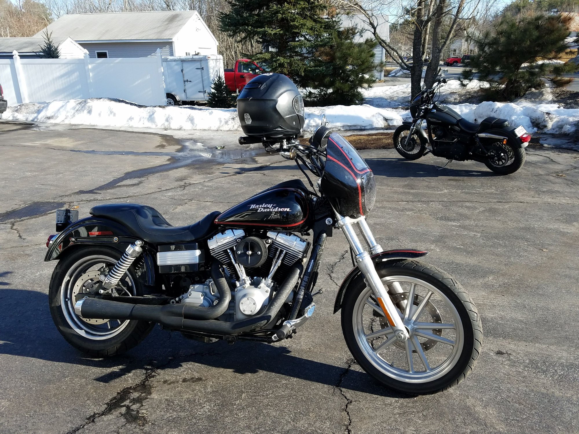

Got the bike all finished up Tuesday! Initial start up went well, no oil leaks, no exhaust leaks, no intake leaks. Slowly brought it up to operating temp Tuesday night. We trailered it back down to my place the following morning for the break in ride (kudos to Dad for letting me take up his basement all winter with this thing ) We had an awesome 72 degree day up here yesterday and did 60 some odd miles with the boys, changed the oil, and went for another evening ride!
So happy with the result, the bike pulls so much harder now, and comes on way lower than it used to. Shout out to Jamie at Fuel Moto for hooking me up with a map for the build. Planning on doing a compression test once I get some more miles on her but so far everything seems good.

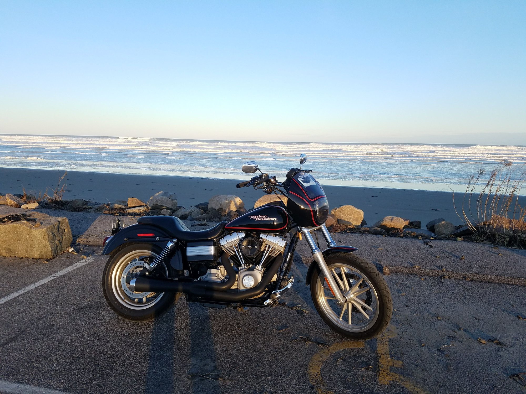

Break in is all finished! Took the bike over to the beach today before we get hit with 10-18" of forecasted snow later this week... Also took another quick video with a couple revs. SHE SOUNDS GOOOOOD!
