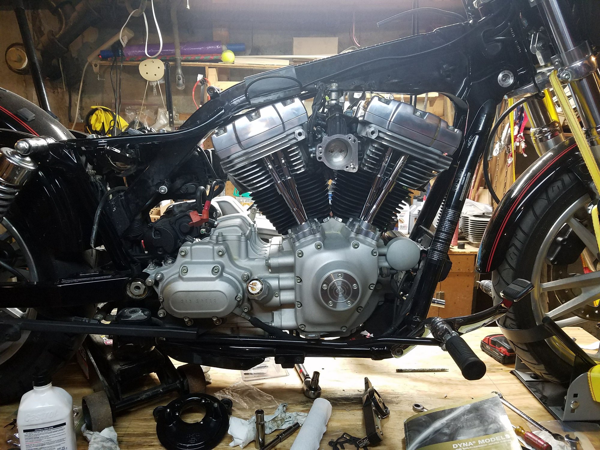

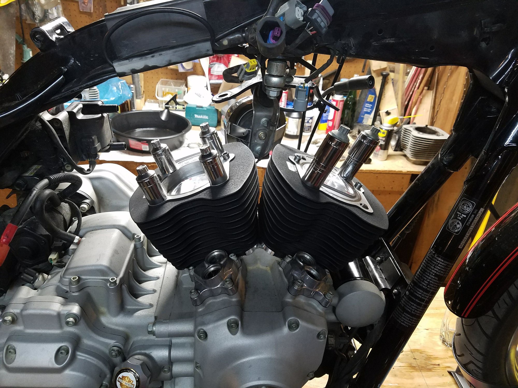

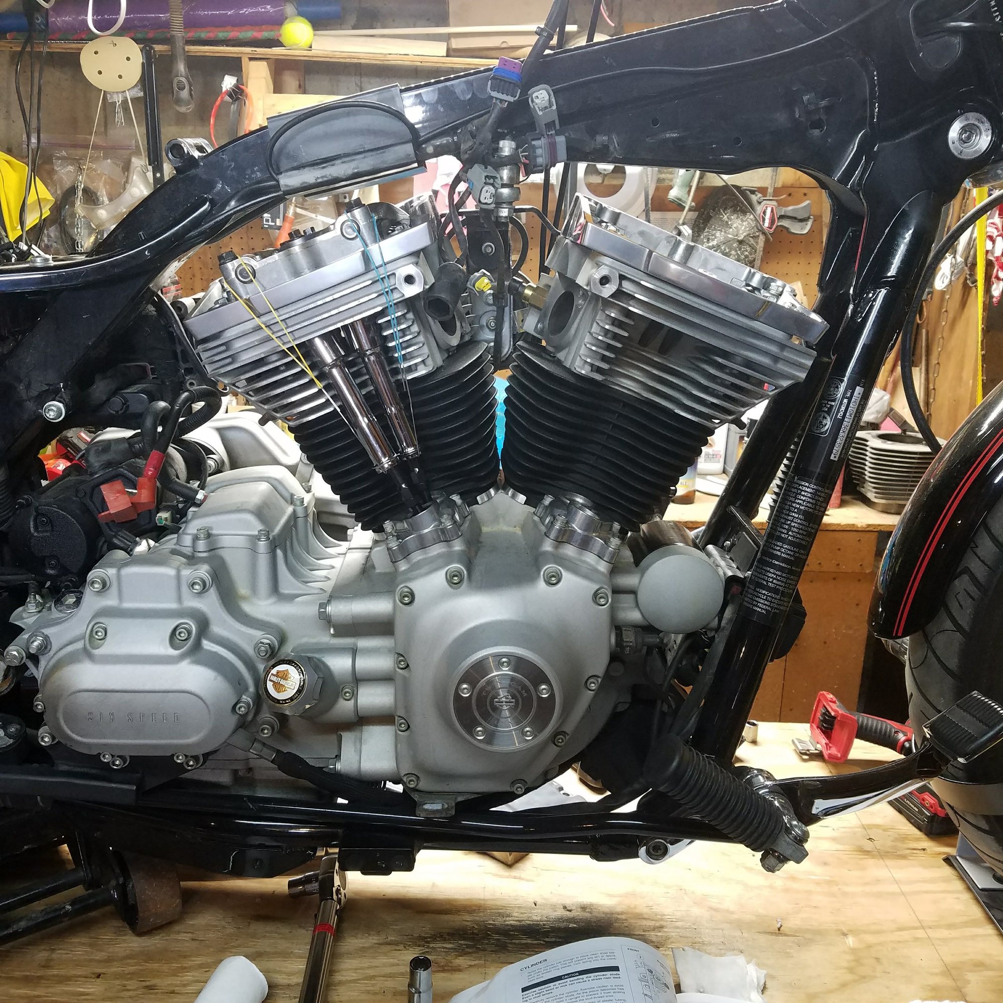

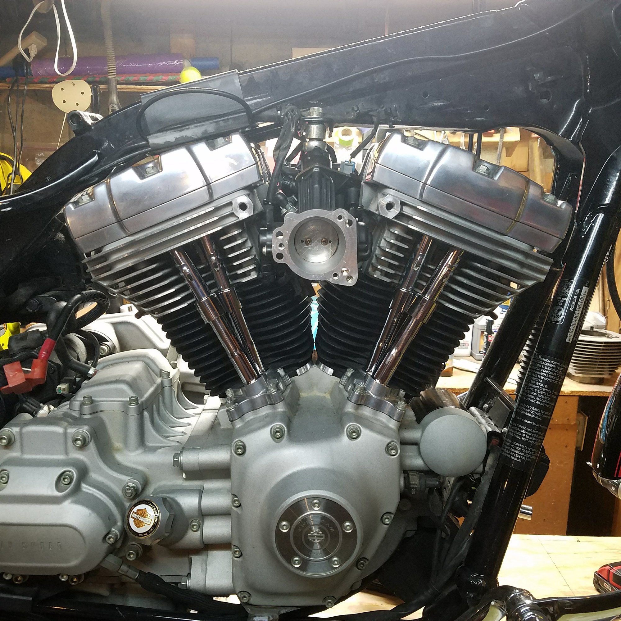

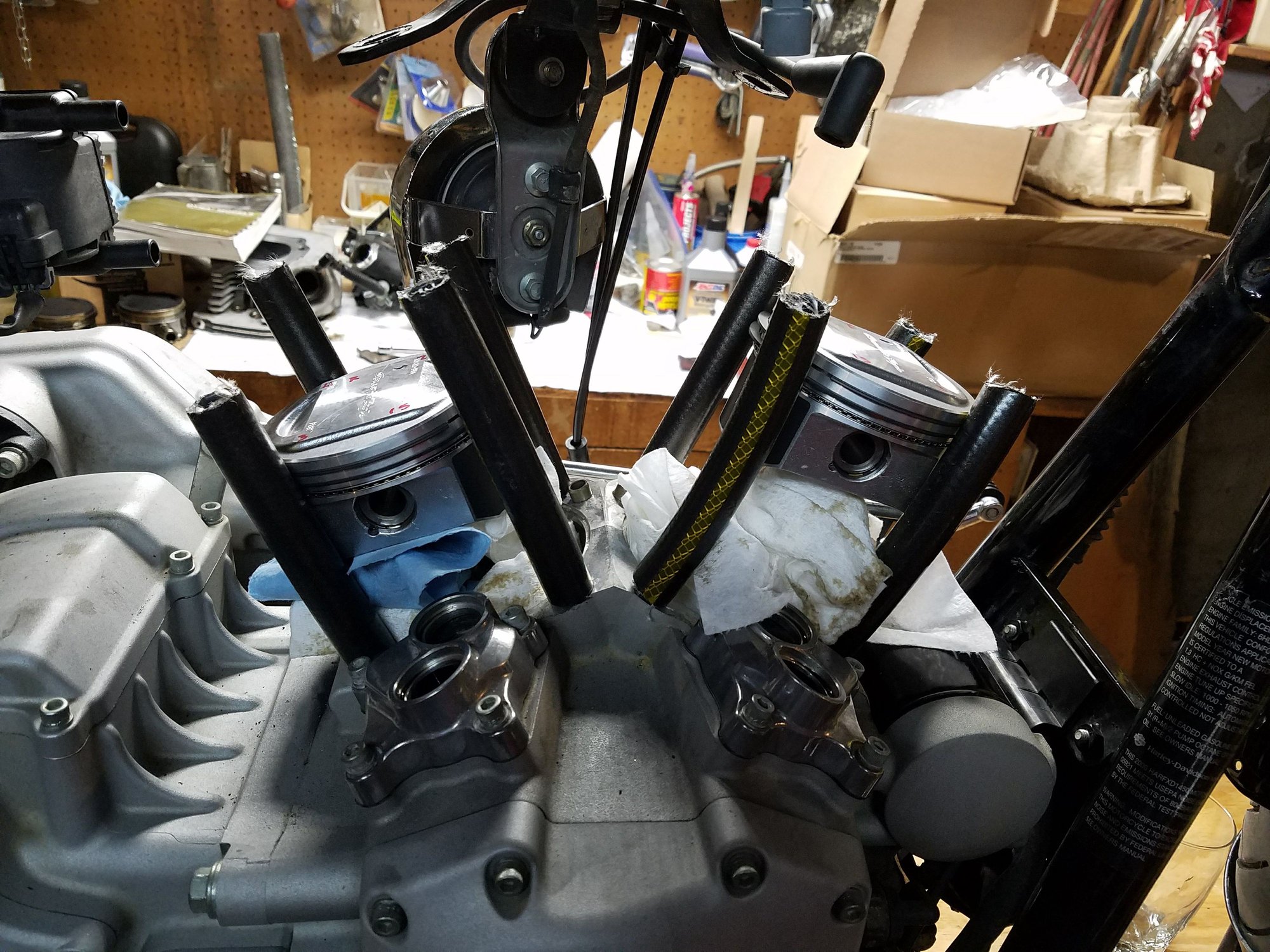

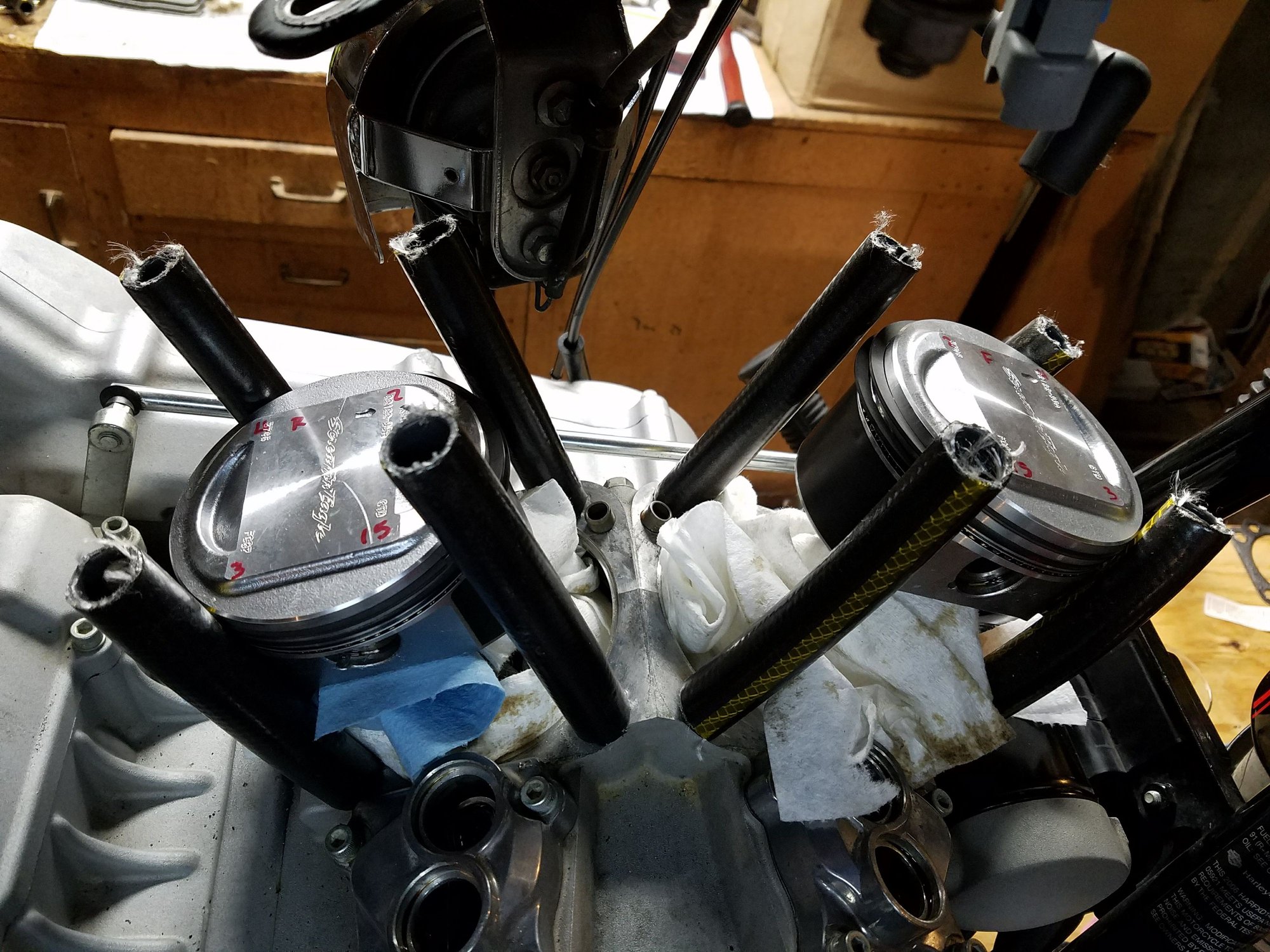

Figured I'd post some pictures from my 95" build I've been working on this winter. The quick rundown for the setup is:
- S&S 570c cams
- Screamin Eagle cast 10.25:1 (3.875") pistons
- Deck height: -.0015" (Pistons above bore)
- James Gasket MLS head gaskets (.045")
- Manual compression releases
- Screamin Eagle adjustable pushrods
- Stock '06 heads
- Bassani Road Rage 2
- S&S Stealth intake
- Dynojet Powervision (FuelMoto)

Originally Posted by johnwesley
I like the black jugs, did you paint them?
It should run good. I’m jealous
I didn't paint them, they were some 96" take offs my buddy had lying around from when he did a 103" big bore. They're the factory wrinkle black finish from his street bob.

Thanks man! I haven't ran an actual compression test yet but from running all my measurements through the Big Boyz calculator, I should be running around 197 psi / 10.26:1 static / 9.43:1 corrected. I'm not sure what the compression was on the bike before I did the big bore, nor do I know what the deck height was, and I haven't CC'd my heads so there are some unknown factors, but with some "assumed" values plugged in I should be looking at around a 40 psi compression increase on both cylinders. I installed the S&S 570 cams last winter on my otherwise stock 88". the 40 degree intake close on that cam lowered my corrected compression quite a bit making the bike a dog below 2500 rpm. I was fine with it because I hardly ever ride the bike below 2500 rpm anyways.
I have not done any head work (maybe next winter), and I am still running stock valve springs (maybe those too). Only work done to the heads is the drilling and tapping for the manual compression releases.

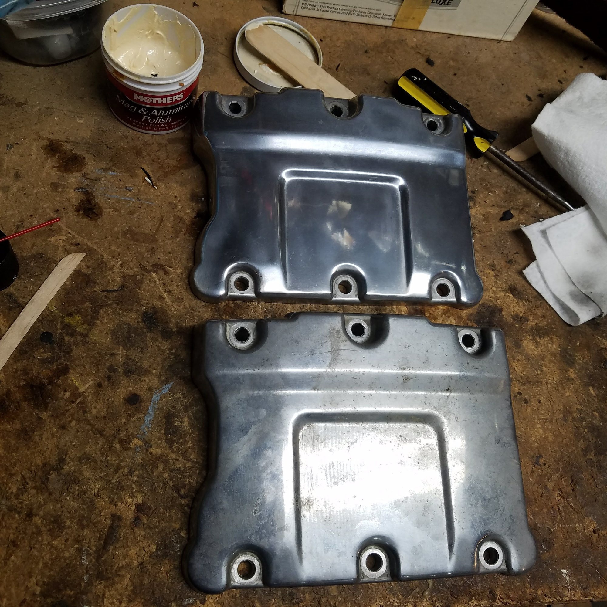

Another thing, if you wet sand your rocker covers over with some 1000 grit sand paper followed by some rubbing compound, that Mothers will make them shine up real good.
