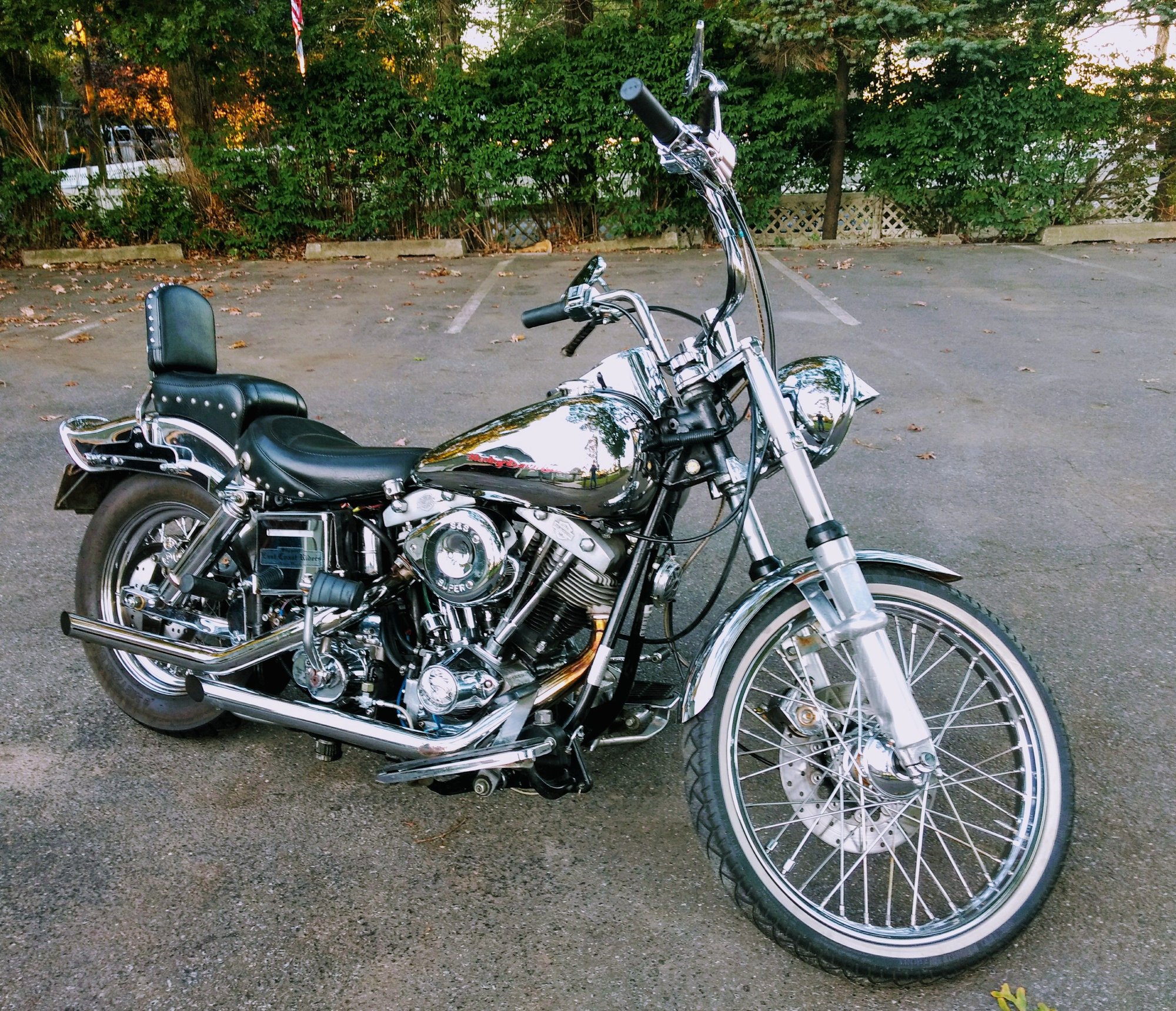

[QUOTE=98hotrodfatboy;17129028]Glad to hear.... Now get it and enjoy that new power.... Hopefully looks like I might be able to get out on the shovel Wednesday... Fingers crossed.... Haven't rode since October....
And what shovel do you have - of all the bikes i have owned and ridin miss my old FXEF the most
Last rendition before i had to sell Her
