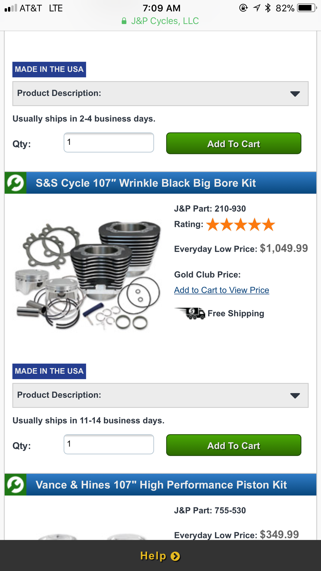

Old Mar 9, 2018 | 06:18 AM
Brenschu's Avatar
Brenschu
Joined: Jul 2017
Posts: 24
From: Middleboro
Or how about this kit...
Old Mar 9, 2018 | 06:52 AM
98hotrodfatboy's Avatar
98hotrodfatboy
Posts: 21,116
Likes: 7,640
From: Poolville
The op could save 300-400 by going to a reputable Indy by using his jugs and they will make sure of the Piston fit and ring gaps are proper...
Old Mar 9, 2018 | 08:30 AM
cody.a.e's Avatar
cody.a.e
Joined: Dec 2017
Posts: 53
From: Southern Maine
Get some CP Carillo pistons and do what hotrod said ^^^. If you use your existing jugs, your piston to wall clearance will be set up based on the measured diameter of the piston. Not just parts grabbed off a shelf and put in a box. If you've got the cash, get the heads done too, big gains to be had from good porting.
